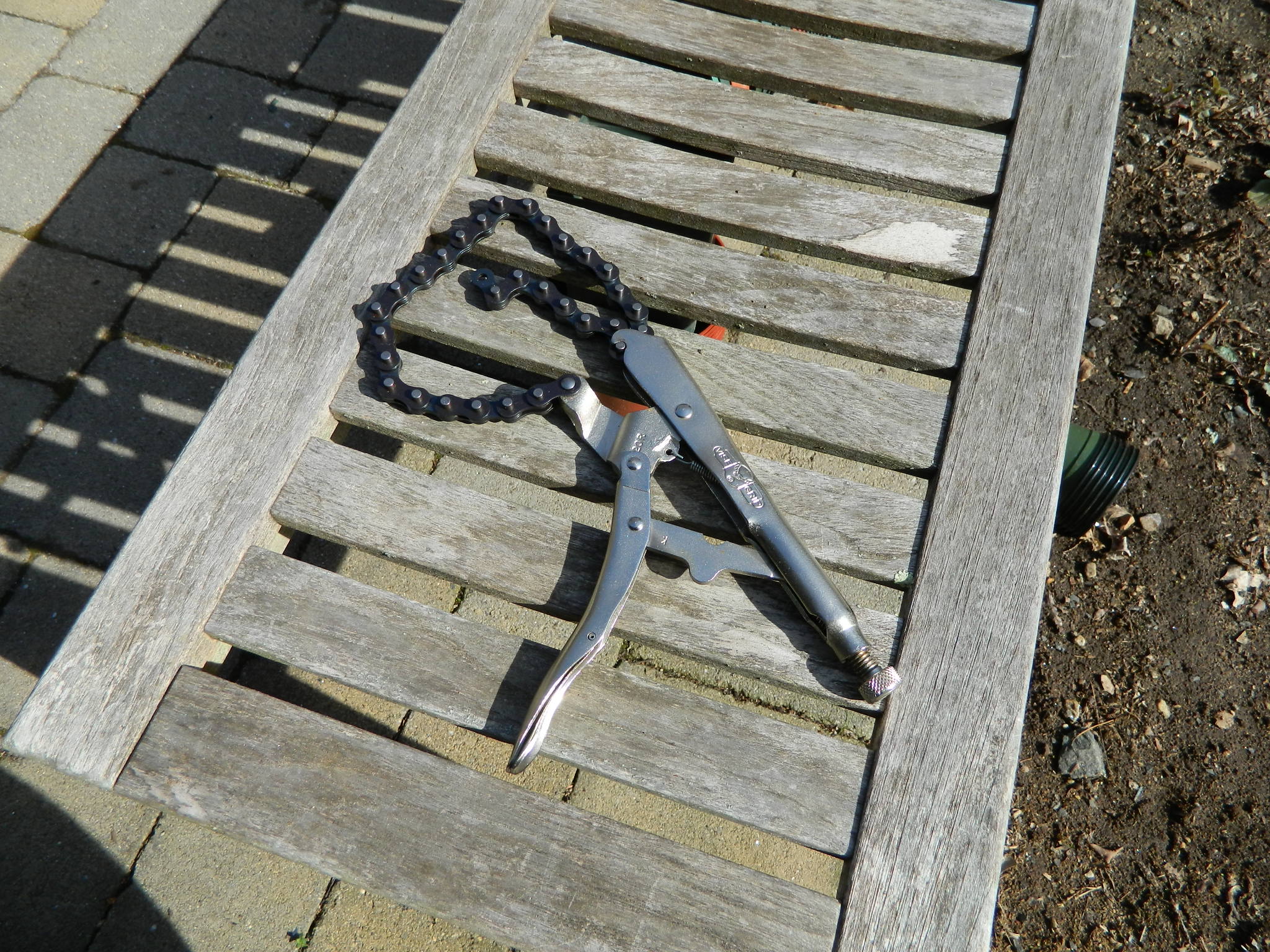

Here's my tool for the tough filters. As long as you have enough space...you have max grip and max leverage.
Reminds me of the first Crocodile Dundee movie when the NYC punk pulls a switchblade on Dundee, who then pulls out his 16" Bowie knife. Then he says to the punk "you call that a knife...THIS is a knife".

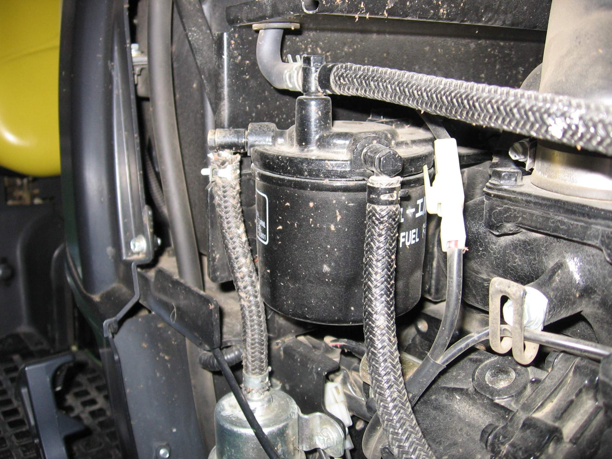

It is the spin on fuel filter,not the sediment filter.:)
Greg
Thanks Greg. I missed that in your earlier post. Didn't realize the 2520 had the separator prior to a fuel filter. That sure looks to be an awkward place to reach with a filter wrench.
Surprisingly, the operator's manual doesn't show the fuel filter (other then the one at the sediment bowl).
The only thing the (online) manual states about the fuel filter in the hours interval...at least that's all I could find.
/ Fuel Filter #24
I think the pic Roy put up does show the fuel filter as well as the separator (sediment bowl and screen) but the writer of the manual didn't get it straight.
Here is jdparts.
#23 being the fuel filter
# 9 being what they call the 'separator'
#11 referred to as the filter element.
#21 the fuel pump.

I think I'm going to invest in one of those. Sometimes the strap wrench wants to slip and in the case of the 2520 spin on,it is very difficult to get the channel locks on the filter without screwing something else (fuel lines) up.
Yeah, they (JD) couldn't have made it more difficult if they had to. As for the manuals,it's too bad they don't revise the darn things. It's not like there aren't enough "mistakes" to correct to warrant the new manual.
