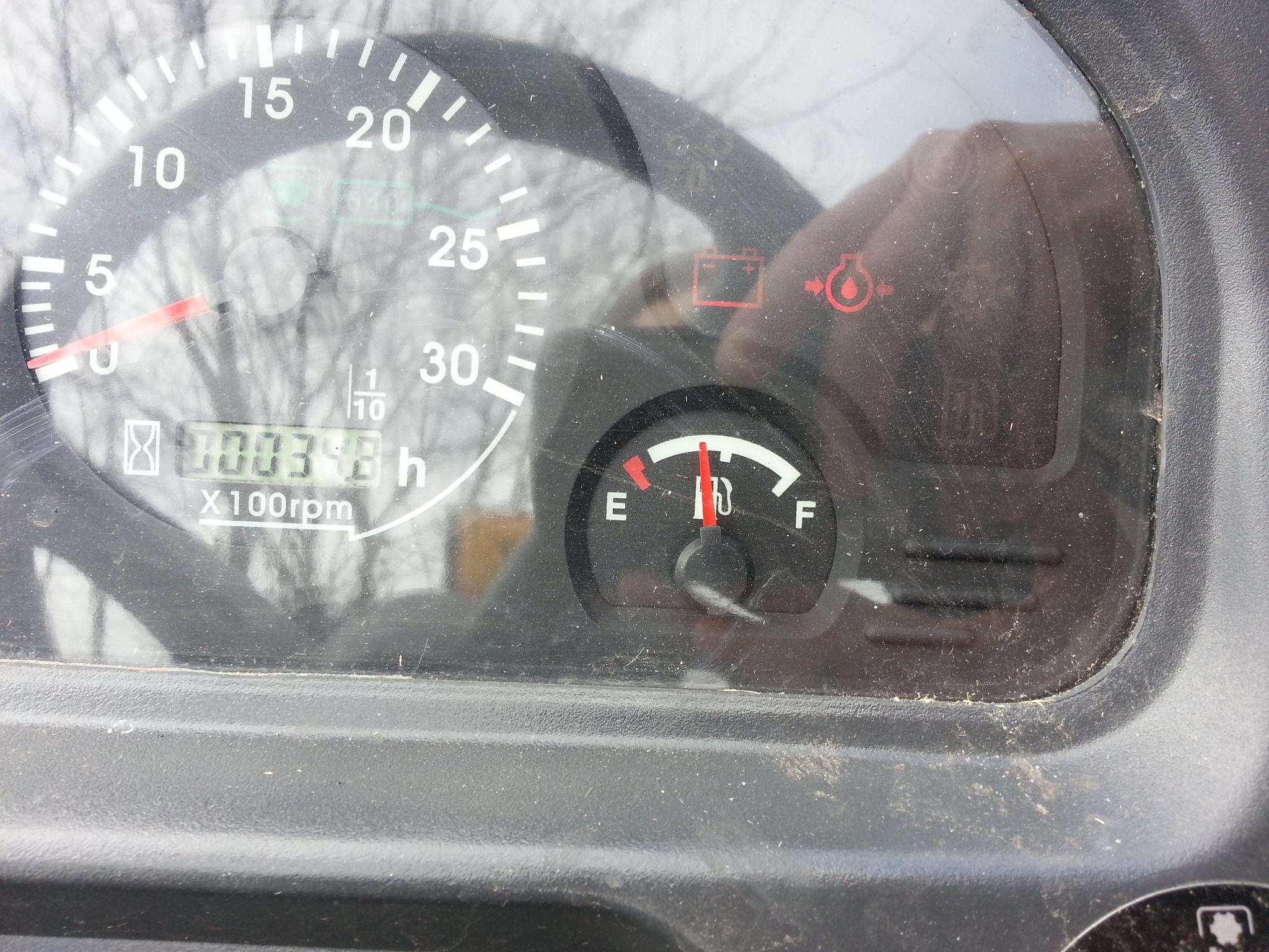

Well, I ran out of fuel already!!! Hard to believe I have already put close to 16 hours on it!
Also hard to believe I ran out of fuel... :confused:
I will be contacting the dealer.... Sorry, but this just aint right!!

Float is probabley stuck!

Sorry to see that. Not sure about the other LS models but the R series models are notorious for being inaccurate. It has been discussed here before. My 4041 is living proof albeit not as bad as yours. When mine hits 1/4 tank I start making my way to the fuel depot.. Luckily I haven't run dry yet.

Mine is opposite, it shows empty when it still has about 1/8 of a tank so it is pretty accurate. I would much rather it show less than actual than the other way around. No way should it show 1/4 or more and run dry. New sensor time.

Just got off the phone with the dealer, he said they have seen it before, and what happens is the float hits the side of the tank and doesnt drop all the way.
He is sending one of his guys over this afternoon to fix it.
Still a little shocked I ran it dry at roughly 16 hours of LIGHT use!

So he came and pulled the sensor, messed with it for about 5 minutes, and decided he is ordering a new one. He said he didnt like how it was behaving in the bottom range of motion.

If you hadn't posted the fuel gauge pic showing almost half a tank (when in actuality empty) I was going to say they don't run on air alone. You do have to refill them once in a while. If you got 16 hours from an 8.3 gallon tank that's only .51875 GPH (slightly more than 1/2 GPH). Real good for its size.

My R3039 has the same 'issue'. As the guage indicates less fuel than actual, I leave it be. Nothing wrong with having a reserve. I still get 16 hours per indicated tank running mostly under 2000 RPM.
