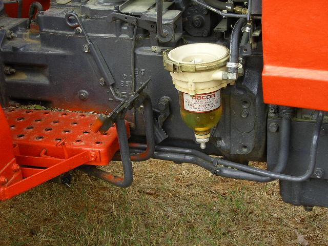

Isn't this system a gravity feed like my L2500? If I recall the line goes up to the injectors then into the top of the tank. I don't think there should be any pressure on it. I would check all the hoses to see if they are clogged. Also if it's that new of a tractor I'd check with the dealer, let them fix it.

Interesting but I don't think I missed it on my L2500. When I installed the Racor I ran the line from the tank bottom, to the Racor, then through the sheet metal to the bleeder valve on the injection pump. Gravity feed the whole way. Maybe the smaller tractors have a lift pump because everything is flatter (so to speak). My BIL's older L175 doesn't have one either if I recall. Out of all my documented pictures of my L2500, I don't have one with the engine covers off. On my to do list.
Just looked at his pics again, lift pump just below injection pump. And the 3430 should be a little bigger than mine but is a newer model. And I popped into my L2500 parts PDF, and no lift pump. Now I feel robbed!! /forums/images/graemlins/grin.gif
