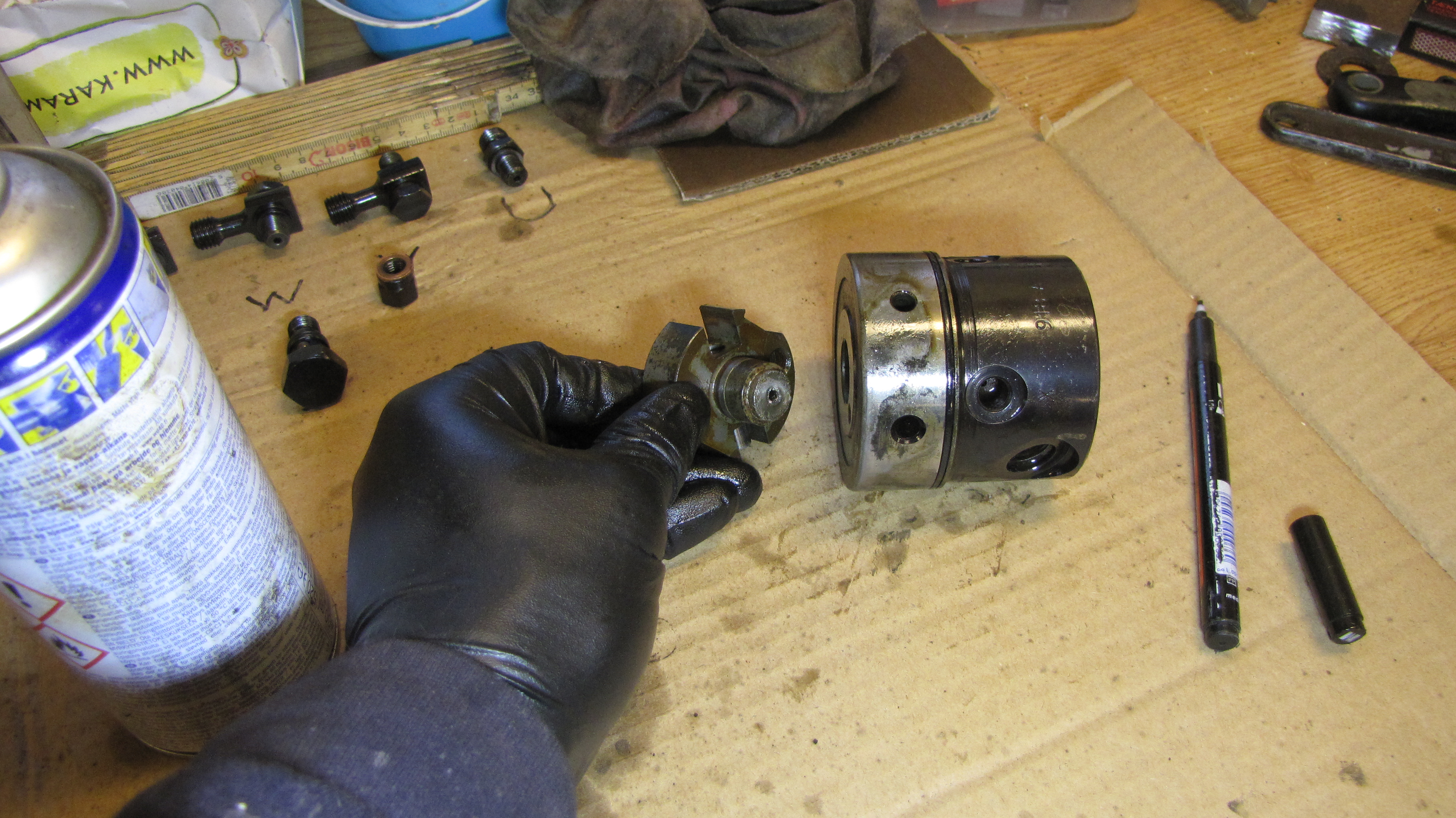

They say a picture is worth a thousand words - this is the broken pump head from the pump - it has been replaced with a new pump head. So most of the broken pump was still rotating, up to the broken axle, and more importantly, the pump gear, that is in time with the engine was still rotating.
There are no timing adjustments on this type of pump - when assembling, all gears have one double tooth, so they only go on one way, so there is no way to assemble the pump "out of time".

The engine timing is controlled by the timing gear that hopefully is still timed the same way with the engine. So no, I cannot answer your two questions, and i believe that I do not have to be able to do so.
So it is in time and runs perfectly? You are go to go!
If all of that statement is in error, then you have an issue. The simplest explanation is that when cylinder 1 needs fuel, your pump is injecting fuel to cylinder 3 (180 degrees out of time). The problem here is that cylinder 3 needs fuel that has just been compressed and now is ready to burn that fuel.
So it is in my opinion entirely possible that you have the engine and the pump out of time with one another. If what I state above is happening your engine may on occasion try to fire, but every cylinder gets the needed fuel at the wring point in the process, it just never catches.
Get a service manual and follow its procedure for reinstalling an injector pump.

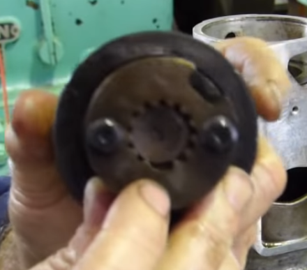

As I explained earlier, the pump was turning, just not the parts that delivers fuel, the shaft is splined, where one spline is a double, so it cannot be installed wrong - see picture of similar pump head.
So in my opinion I installed it WITH regard to where the distributor plate was timed, and that is why I don't understand why it could be out of time.

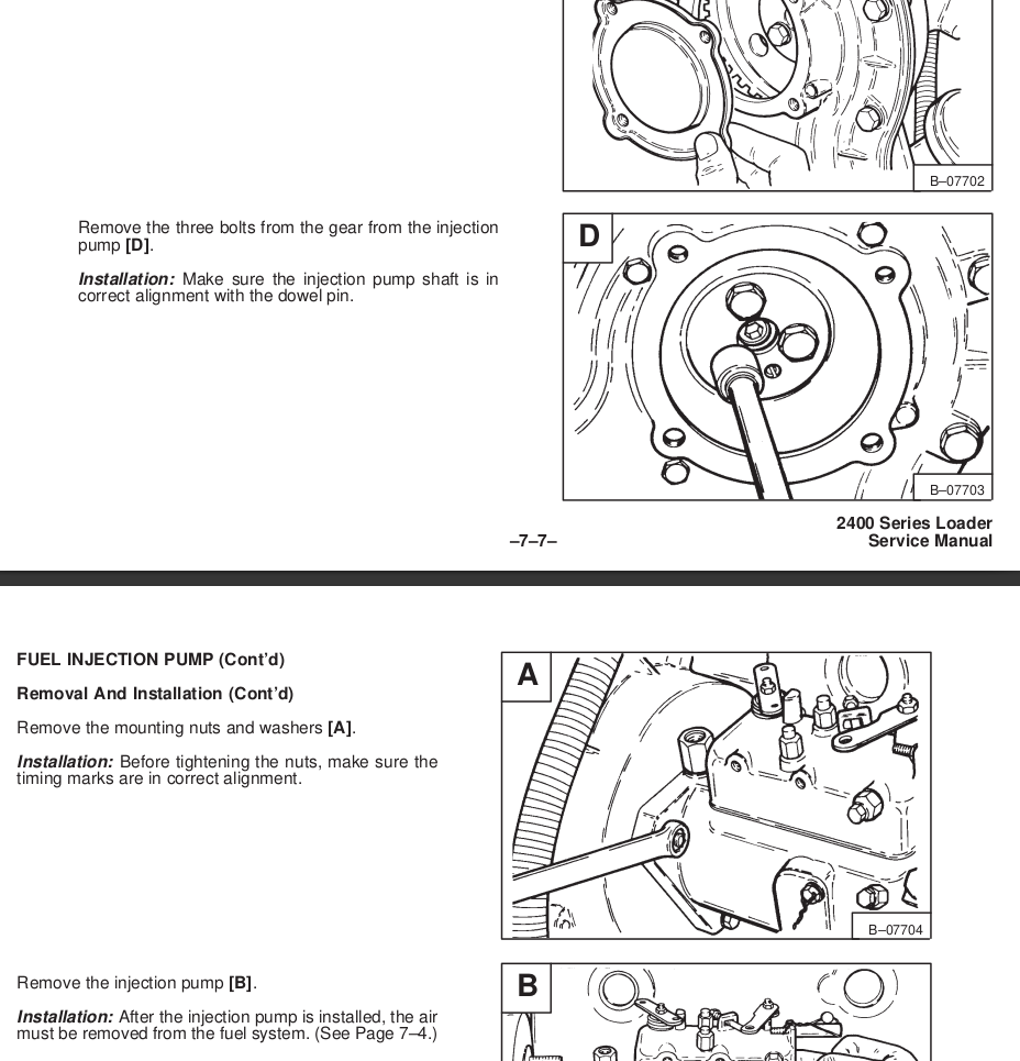

This is the part in the repair manual that mentions injection pump removal / installation
So basically, the pump shaft should be in alignment with the dowel pin, and the timing marks should line up again. It makes no mention of any other timing adjustment being needed - It does not mention any risk of mounting the pump 180 degrees out of time, so I would not expect that it was possible to do that since it is not mentioned in the repair manual.
So, again, the only reasonable explanation I can think of, would be if the forces that broke the internals of the pump also made the pump timing gear skip one or more teeth.
So I guess I have to remove the valve cover, and rotate the engine to TDC on cylinder 1 compression stroke, and verify if the letter "C" in the fuel pump inspection window is in alignment (this is from the manual)
If not, that would verify that the engine and pump are out of time, and I have to disassemble the engine further to get access to the timing case and adjust the timing gears.

My suggestion remains to retime everything according to the procedure as printed in a service/repair manual for the tractor.
If as others have indicated the cam turns 1x for every 2x of the crankshaft, out of time is possible with alignment of the cam and pump.
If you want to not follow the service manual procedure, pull the pump, rotate the engine 1 full turn of the cam shaft, reinstall pump, bleed fuel lines from tank to injectors, try starting engine. Since you do not know where the pump timing is located, it may take several tries to find the correct timing alignment.
Seems simpler to find timing procedure for pump install and follow it.

People stop to consider, the pump engagement pin on engine can only fit one way on pump, impossible to get it out of time.... The splines on pump drive are also keyed to pump shaft so it only goes on one way.... By the shear nature of the mechanics the pump can not possible be assembled on engine out of time (except for a few degrees at mount) ....
IF the above is not true, the pictures are lying to all of us.... Don't believe the problem is "timing"..... believe something else is askew here....
Maybe the gearing inside engine case has jumped a few teeth, maybe cam drive is a few teeth off, but then it would not run good with starting fluid down air intake....
