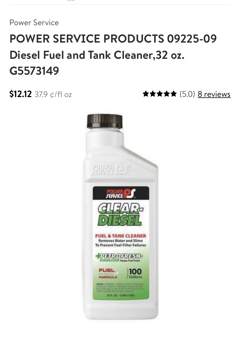

On my MF 231S, fuel tank has something like baffle in it. Pressure washing would not get to bottom. Have anyone tried this product?

Purchase one gallon of Super Clean at Walmart (less than $10.00). Ad it 1:1 (use water) to empty fuel tank. Agitate. Rinse with water. Dry. Change fuel filter and fill with fresh fuel.
Use caution. Super Clean is a very aggressive cleaner containing harsh chemicals that can damage skin.
