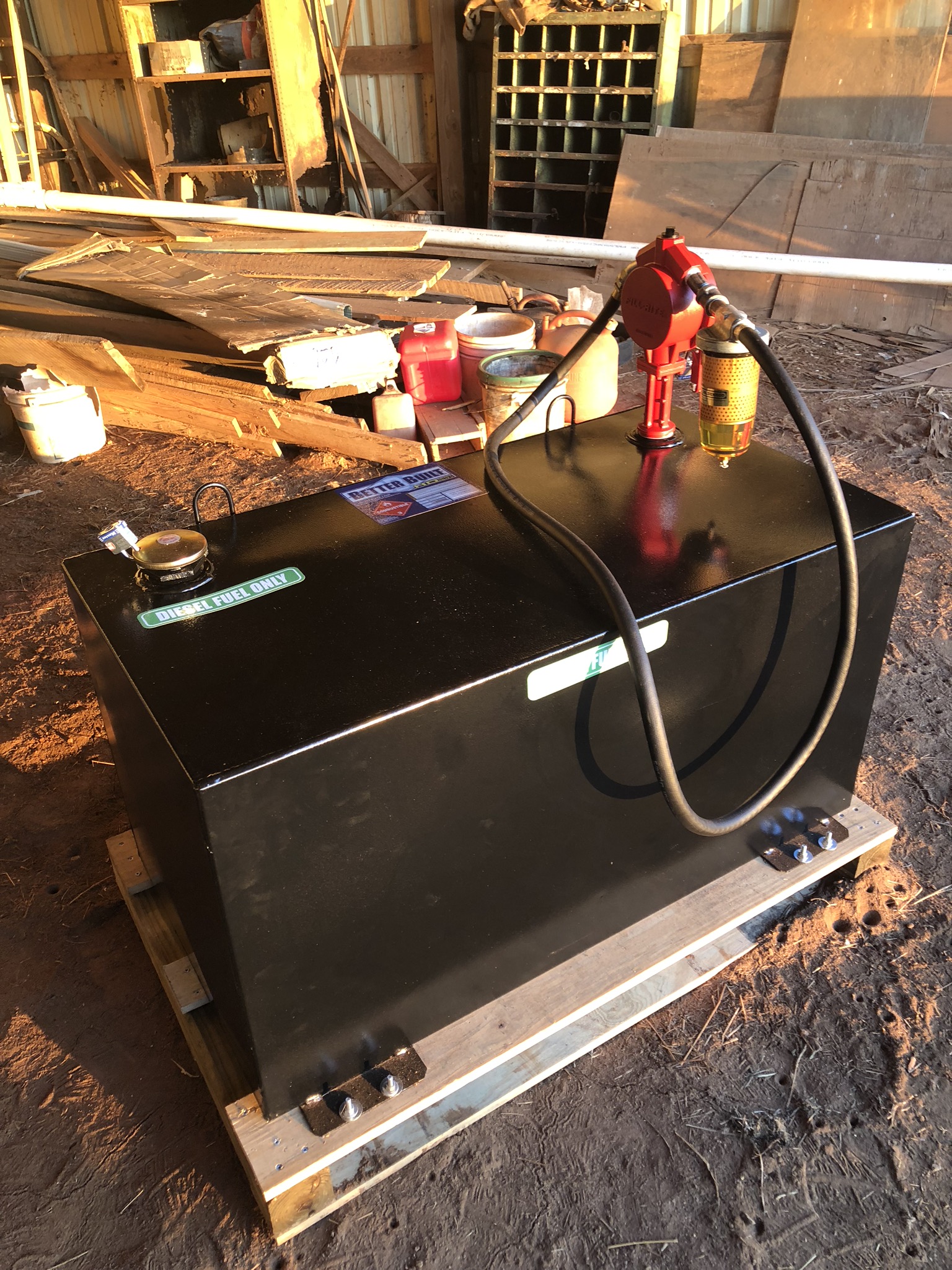

I received my "Diesel Fuel Only" stickers yesterday which completed my fuel tank project. The tank is a 100 gallon Better Built transfer tank with a Fill Rite FR112 rotary hand pump and Goldenrod fuel filter. I bolted it to a pallet made from treated lumber with the hope that it'll last a little while longer than untreated.
It was easily loaded on the truck and transported to be filled with fuel. Unloading was just as easy. I have filled the tractor a couple times already which was a lot easier than standing up on the brush hog while holding 5 gallon cans up to the tractor's tank.
Now if I can only remember to replace the tractor's fuel cap after filling. Yes, I lost my cap last Saturday and ordered/received a new one from Messick's in record breaking time. Thank you Messick's!

Looks great! I would like to do that one day. What was total cost?
   / Fuel tank stickers?
#14
Best I can remember, fuel tank from TSC $319, Fill Rite pump from Amazon $140, filter from local supplier $12, 2- Master padlocks and pipe/ fittings ACE Hwd $25
I really like it compared to the old hand crank pumps or 5 gal cans that I had been using. Easy to crank, fills the tractor's tanks pretty quick and no fuel drips from the pump or hose. No hernias- Priceless

Another feature to consider is an auto shutoff nozzle. They are a little pricey, but well worth it.
Will an auto shutoff nozzle work with a rotary hand pump?
   / Fuel tank stickers? #17
Yes. My gasoline tank has a rotary pump since I only dispense small amounts at a time.

Thanks for the info. I've been trusting my hearing for when the tractor's tank is full but that don't always work so well.
