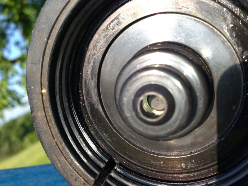

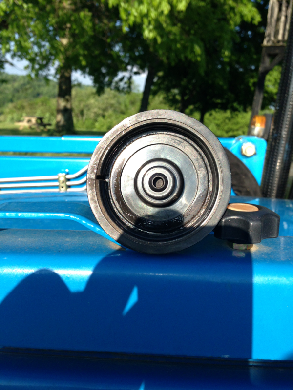

Can I get you LS guys to check your caps and compare to Oz's pic above. Can you all confirm whether or not there is a little pin hole in the center of that relief disk?
   / Fuel Tank Vacuum #22
May this better I don't see a hole just a mark.
   / Fuel Tank Vacuum #23
There is no hole there. This cap is an assembly as most are where there is a valve inside for safety and it opens when it needs to. The older caps such as Ford N series and IH H and M, etc. just had a hole in them but for the last thirty years they have put valves inside the caps.
   / Fuel Tank Vacuum
#24
I see --- Thanks much ---- That's what mine looks like. Guess all I can conclude is that I'm OK!! Much ado about nothing. Thanks to everyone for the help and insight --- VERY MUCH APPRECIATED BY ME.
