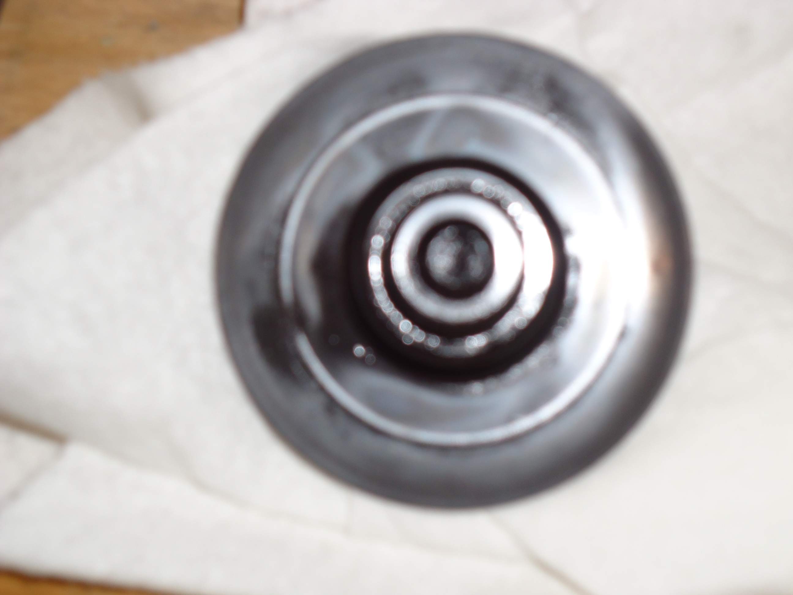

My vent is in the tank's cap.
Thanks --- I see it. I'll check my cap to see if it's the same ---- on my cap, that disk that has the vent hole in it will freely fall out of the cap. Is yours the same?
   / Fuel Tank Vacuum #14
It's in there tight. I don't see coming out unless the cap was broken in 1/2

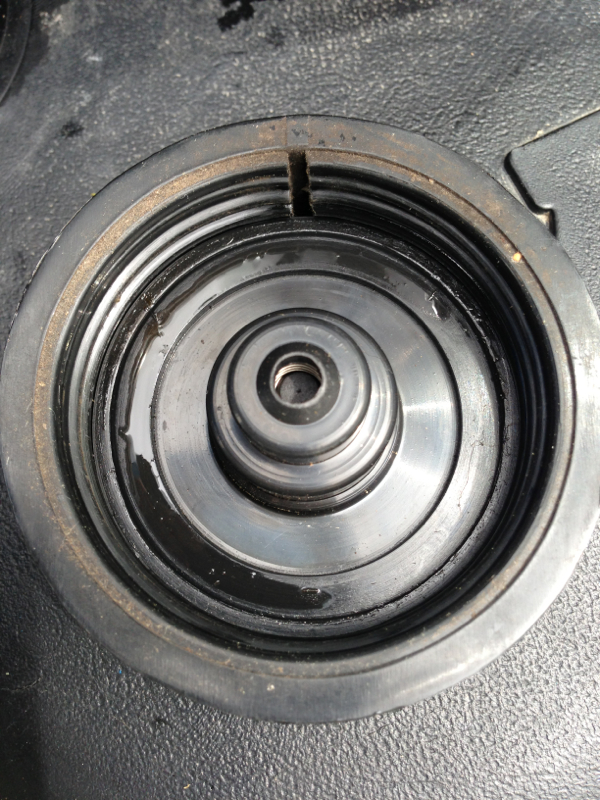

OK --- I took that disk with the vent out of my cap. It looks like yours definitely has a pin hole in the center of that soft, flexible membrane that's dead center of the disk. Mine has no such pin hole --- it's a solid, soft flexible membrane. Maybe that's my problem ---- picture below without the cap.DSC00184.jpg
   / Fuel Tank Vacuum
#16
Lousy pic --- hopefully, this one is better.
   / Fuel Tank Vacuum #17
<img src="http://www.tractorbynet.com/forums/attachment.php?attachmentid=317206"/>
When you look into the center of the disk on mine, that light colored gray is a spring.

So, there's no pin hole in that membrane?? I could swear that I see a pin hole in that first pic that you posted --- And, I agree --- the light colored gray around the outside edge looks like a spring to me too.
   / Fuel Tank Vacuum #19
Typically the vent is in the cap. If not there is another opening somewhere on the tank but since the cap is on top and there is a already a hole in the tank there, the cap is the easiest place to put it.
