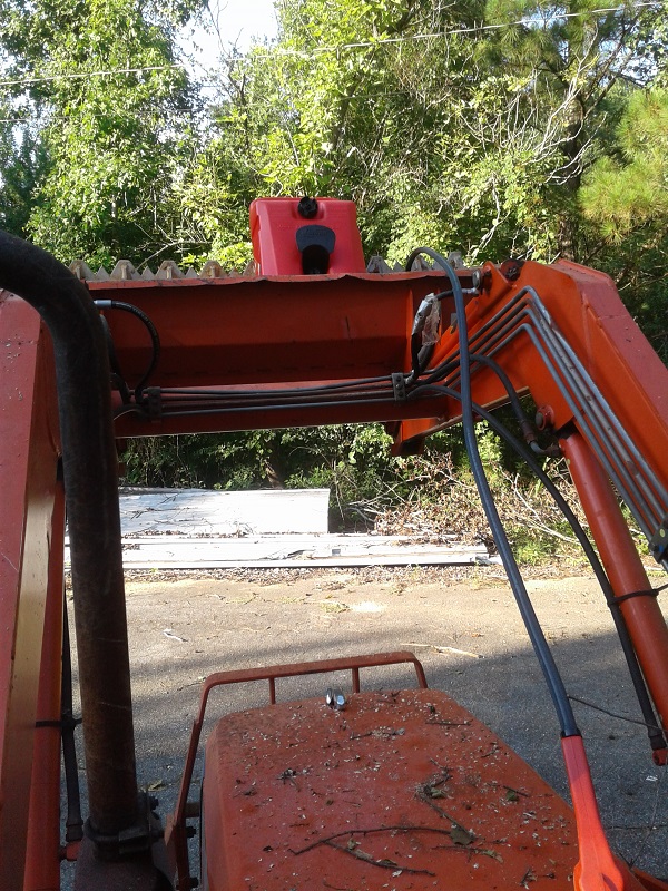

I came across a pump in the $10-12 range that is about 2 inches in diameter and fits inside most fuel can filler openings.
They come with battery clips and wired with on/off switch.
Uses a 5/8" hose (not supplied). Not super fast but adequate for fueling CUTs.
They caution to not use with gas as in fact the small DC motor runs actually submerged in the fuel and sparks would like to ignite gasoline.
I have used mine now for 2 winters and really it.
One neat feature is that there are no close tolerances so when you switch off the remaining fuel in the filler line simply drains back to tank.
Like no fuss no spills.
Basically a simple small DC motor driving a fan or propeller that pushes the fuel.
While not stated I suspect the lift is probably no more than 5-6 ft or so but perfect to fuel a tractor.
Take me about 4-5 minuits to fuel up now with no spills and better yet I no longer heft a 5 gal reservoir at arms length onto my tractor hood.
These little fuel pumps even have a stainless screen to filter out any trash that might be in the reservoir.
