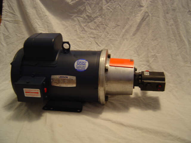

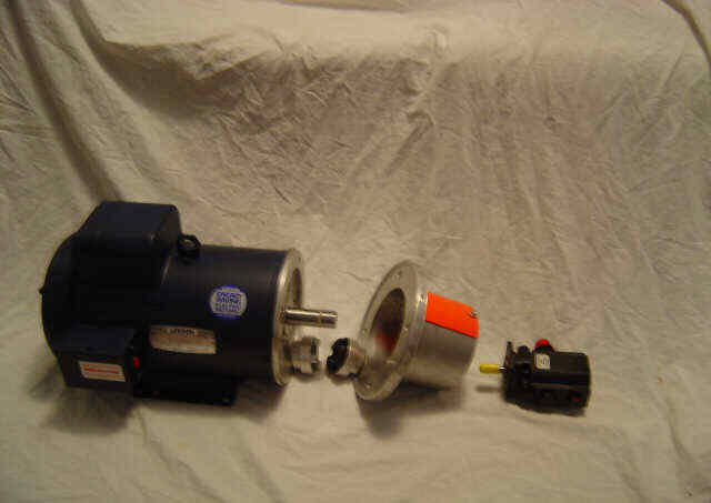

I found a good sight for pump adapters and couplers:
http://www.magnaloy.com

Thought you might like a picture of the pump, motor, and adapter. The adapter and coupling are from Magnaloy.
RonL
   / Full-size electric wood splitter #45
Assembled. I may have used too much compression on the picture.
The motor is a Leeson 5 HP with a 1.15 Service Factor. TEFC. Weighs 103 pounds. The pump is a barnes 11GPM model. I figure this combo should last for the rest of my life.
RonL

   / Full-size electric wood splitter #46
Re: Fqll-size electric wood splitter
Ron, what did I miss? I thought with a 1.15 sf motor and your calculations that you would have gone with the 13 gpm pump.
   / Full-size electric wood splitter #47
I had the 11 GPM pump. If I were to do it over I would probably go with the 13 GPM pump.
RonL
