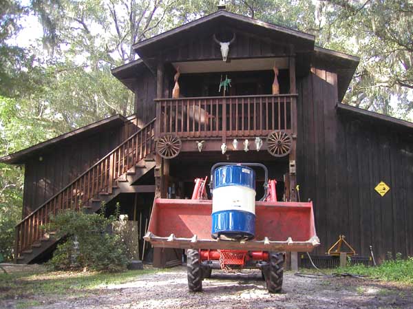

I've got enough to change out all four tractors for the next 1,600 hours of operation.
About 500 pounds of it! /forums/images/graemlins/blush.gif

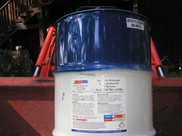

The Amsoil 5W-30 Synthetic hydraulic fluid start-up and operational viscosities are primo for our GST, HST, FEL, and BH's. /forums/images/graemlins/grin.gif

The SAE Technical Paper Series from the International Trends and Developments in Power Fluid for Off-Highway Operation Applications, entitled "Development of High Performance Transmission/Hydraulic Fluid (KUBOTA SUPER-UDT) Establishing the Specification and New Test Method by Nobushige Ichikawa and Tsunejiryo Seno, Senior Lubrication Engineers, Kubota Tractor Corporation, contains the complete specs on the develoment of the Super-UDT hydraulic fluid for Kubota's new GST, HST, and hydraulic equipment and the Amsoil 5W-30 specs out right in the sweet spot! /forums/images/graemlins/wink.gif

The cool thing about this synthetic hydraulic fluid is it is multiviscosity, so it has the best of both worlds as it operates in the sweet spot both hot and cold. /forums/images/graemlins/cool.gif
