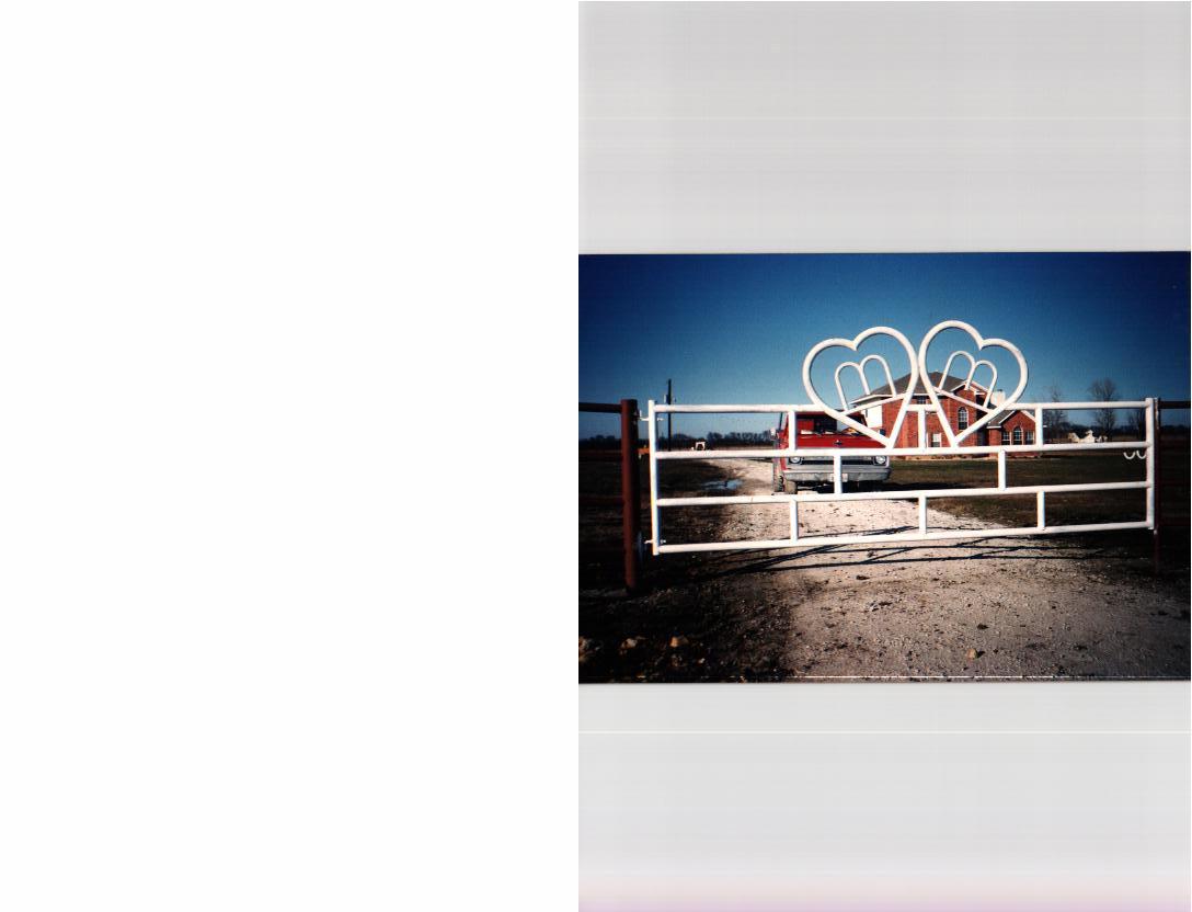

Here's one of my favorite gates of all time. Not because it's so pretty or ornate or anything like that. It is just because it's so appropriate.
He's a Dallas cop. She's a Dallas second grade school teacher. They'd bought ten acres and a home in the country. I was recommended to do the fence.
He was scared to death that country folks were gonna stick it to him cause he was a total novice city slicker. Everything had to be explained twice and then he'd check on things and always seemed to be surprised when it was done just like I said it would.
He'd paid for a straight gate but he'd continually hammered me for something unique. So in a weak moment I'd volunteered that I would do something.
He was like a wife or a kid where a maybe is a promise if you know what I mean.
I put a drill stem and cable fence around his ten acres. I was almost done and hadn't come up with anything yet. And every time we talked he was pumping me for what his gate was gonna look like.
Then on a Monday I showed up at the job and he'd done a dog run for his rotteweilers. As I checked it out with all the empty sacks from sacrete here and there and the slab uneven and not sloped for drainage I just shook my head, rookies.
Then I noticed a little scribbling over in one corner like kids do if they find fresh concrete and no mean adults around. It said "Marlon loves Maria".
I instantly knew what the gate was gonna look like.
I played the hard [censored] and kept mumbling about how I'd come up with something on the gate even after I had it made and painted. Then after the fence was all done I delivered it early on a Saturday morning. As I was unloading it off the trailer he came out in his robe and slippers. He had a grin you couldn't remove with a jackhammer.
"Maria says you did good" was all he said and then walked back inside.
That was worth more than the bucks.

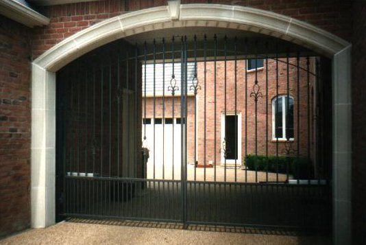

BTW I just installed a low voltage one operator on this gate. What is neat is they have a free exit feature. I've got it adjusted to he can exit free riding his lawn tractor even.

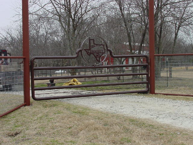

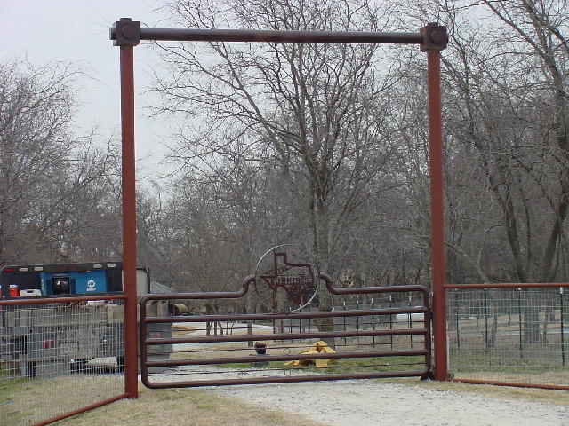

Here's another view of that gate. This is one of those crazy hairs gone wild. This customer told me to do what I wanted as long as someway somehow I integrated that map of Texas with their name in it his wife had purchased at a craft fair.
About that time I'd had a dream about a customer calling me out to do an entryway made to looke like tinker toys. You know the sticks with the wheels with the holes.
So as an experiment I did the overhead like this just for grins.
It didn't turn out as well as I liked but it did fit in my criteria of being one of a kind, character flaw, first to admit it.
