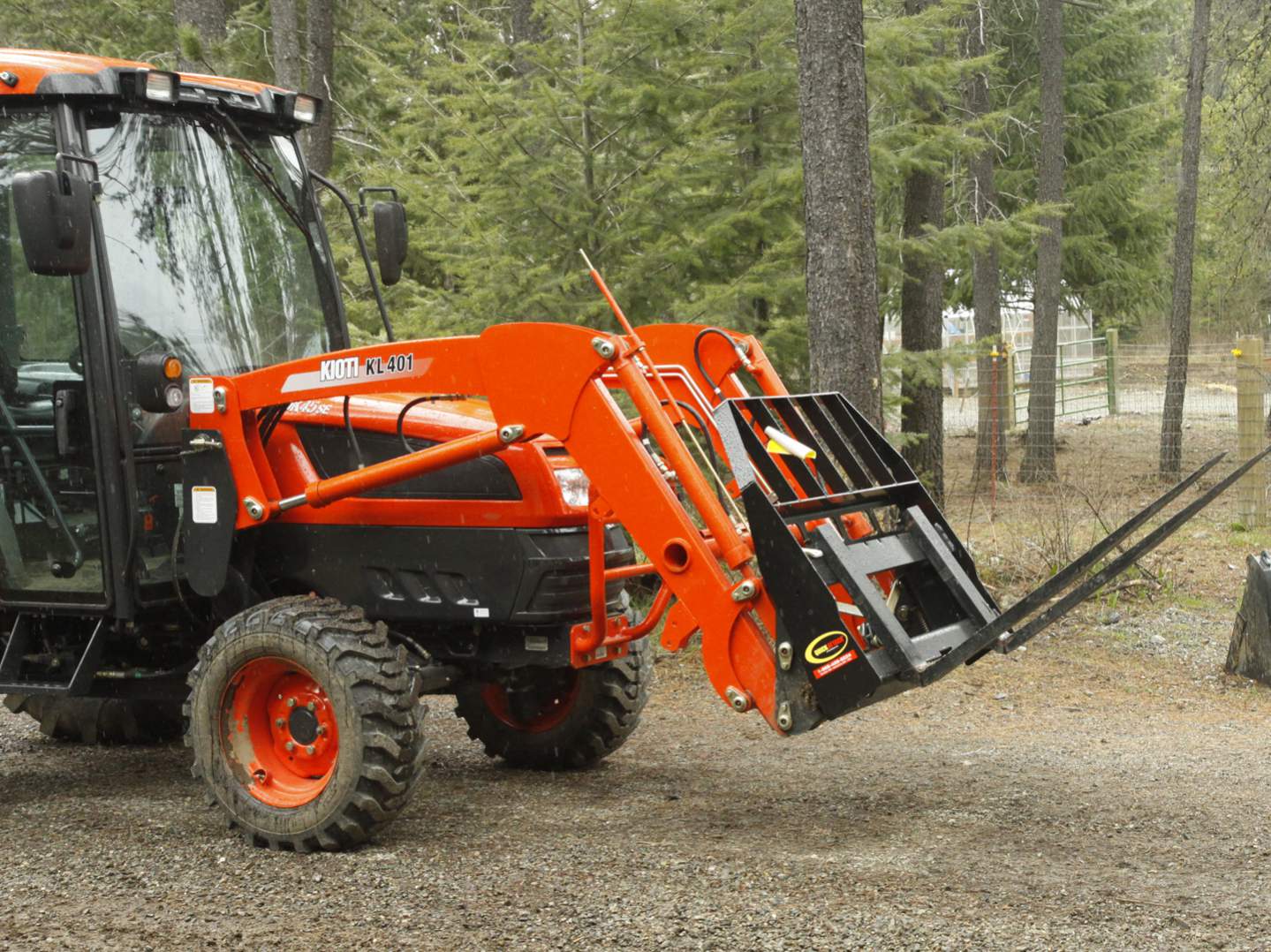

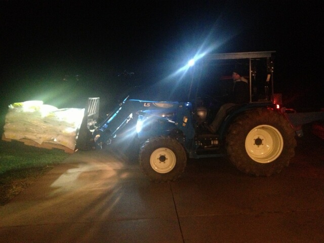

This here is 43 bags (40lbs ea on the same pallet as earlier). I here have 34" forks and they don't have the same heavy duty cage as TSO.
I lifted it approx 2'. I was at 27" but since my driveway begins to slope, this can only be a best guess. I stepped out of the tractor and the rear end was light. I could lift it with two hands (could of got dangerous here). I then went And connected my rotary mower. Wow, much more stable. However, 43 bags is NOT a working load for this. This was just a test for MAX load and I would not drive about this way.
Not wanting to overdue things, I threw ten bags on a separate pallet. Lighting, and transporting the remaining 33 bags (1320lbs + pallet + forks + quick attach plate) was extremely comfortable on various pitch ground. I should of tried various weights for transport but I was in a crunch for time.

Forks used in above test

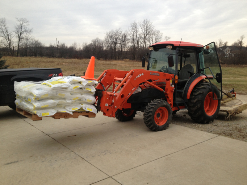

A little photo op this afternoon with TSO
/ Fun with the loader tonight - pallet fork test #57
Reminds me of an old western movie! :laughing:
