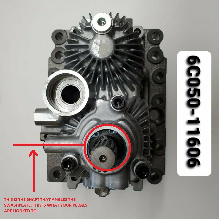

when I press down on the pedal I'm increasing oil pressure which changes the angle of the swashplate, thereby causing the pistons to begin to pump, which increases the displacement as the engine continues to turn the whole thing
I think in most cases your pedals are actually mechanically connected to the swashplate angling shaft (dont know a better term for that) through a linkage, and there is not a fluid connection between your foot and the swashplate. What IS in between is a fluid-filled damper, like a shock absorber, that resists you moving your pedal too quickly (which would cause a pressure spike in the system and possibly break things). So in terms of the oil pressure you mentioned, the pressure you're changing is fluid pressure between the HST pump and the motor it's trying to spin.

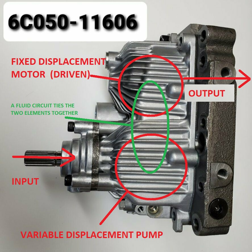

I think that statement was a simple mistake: it's backwards. It's a variable displacement pump hooked to a fixed displacement motor.

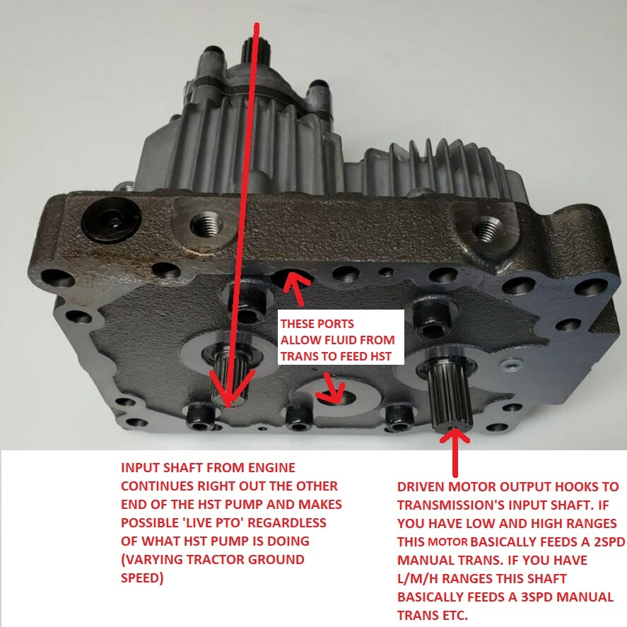

I've made some notations on pictures of a Kubota HST unit i found in an Ebay ad.

Vigo said it before I got to. Hydros are variable displacement pumps, fixed displacement motors. Think of it if your pump was always putting out 50 liters per minute. At max displacement on a motor, pump and motor would turn the same speed. Reduce displacement of the motor and you still have 50 liters per minute coming from the pump so the output speed would increase. As the motor displacement approaches zero, output speed being the displacement ratio, it would be 50/0 or infinity. Hydro motors are always variable. Motors are usually dual displacement except on lower end. Skid steers, compact track loaders, excavators, Kubota Grand L, all I have operated have had dual displacement motors. My GR2120 and RTV900XT have single displacement motors. Dual displacement - large displacement equals lower speed, higher torque. Lower displacement higher speed lower torque.
