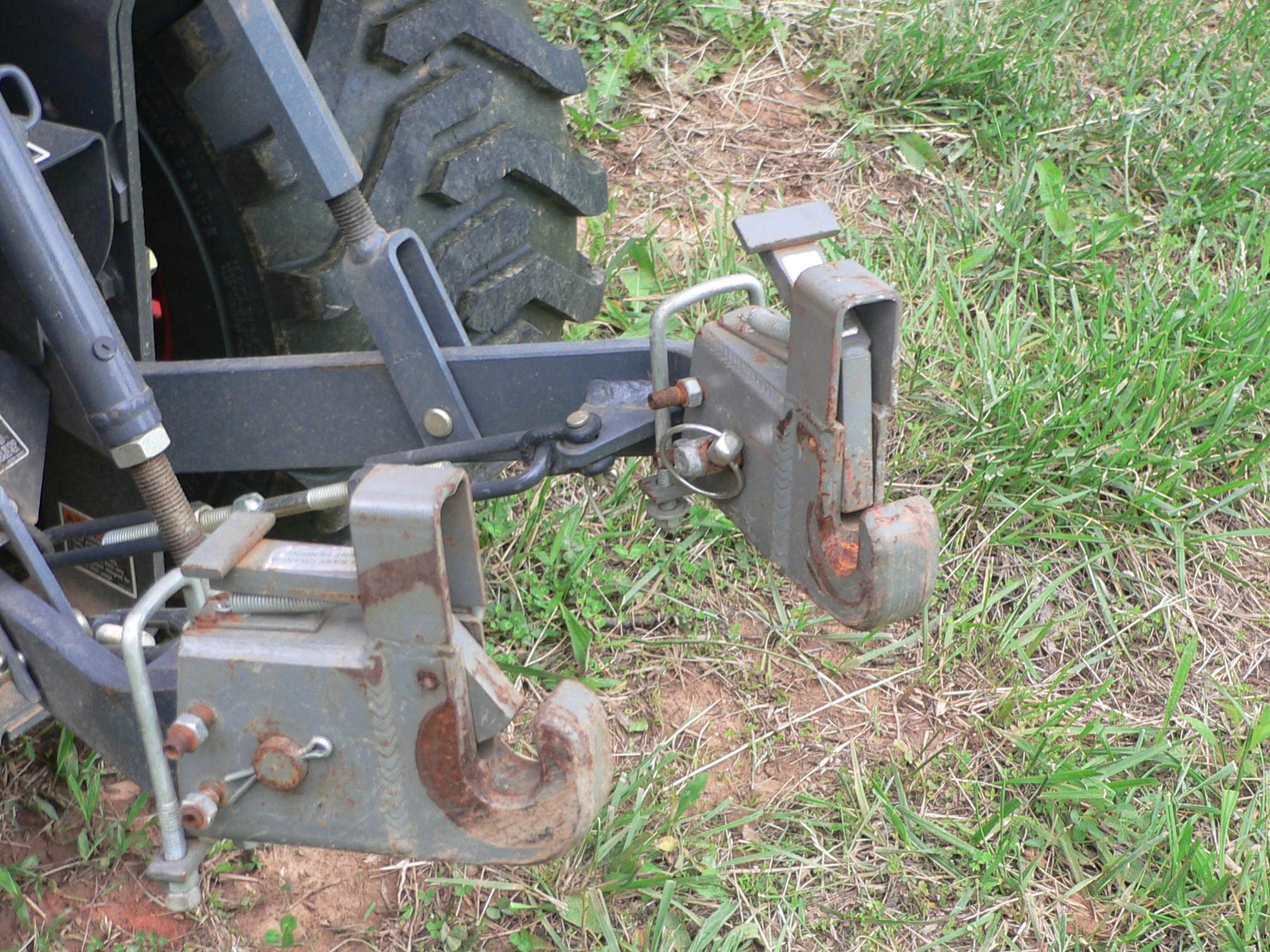

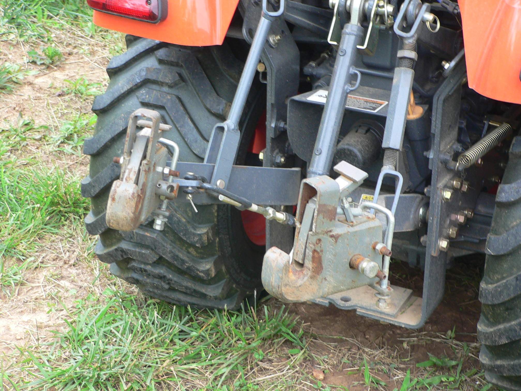

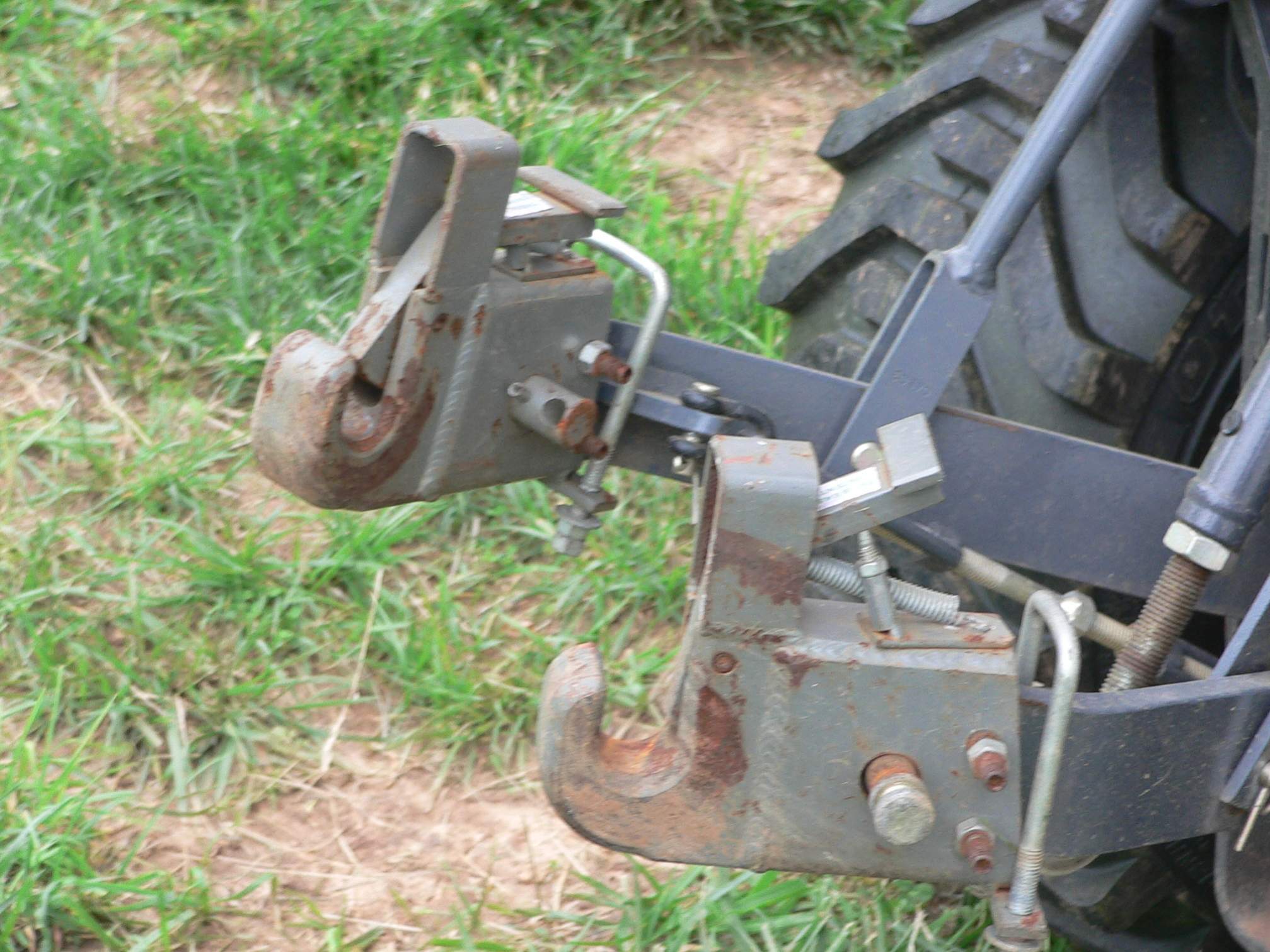

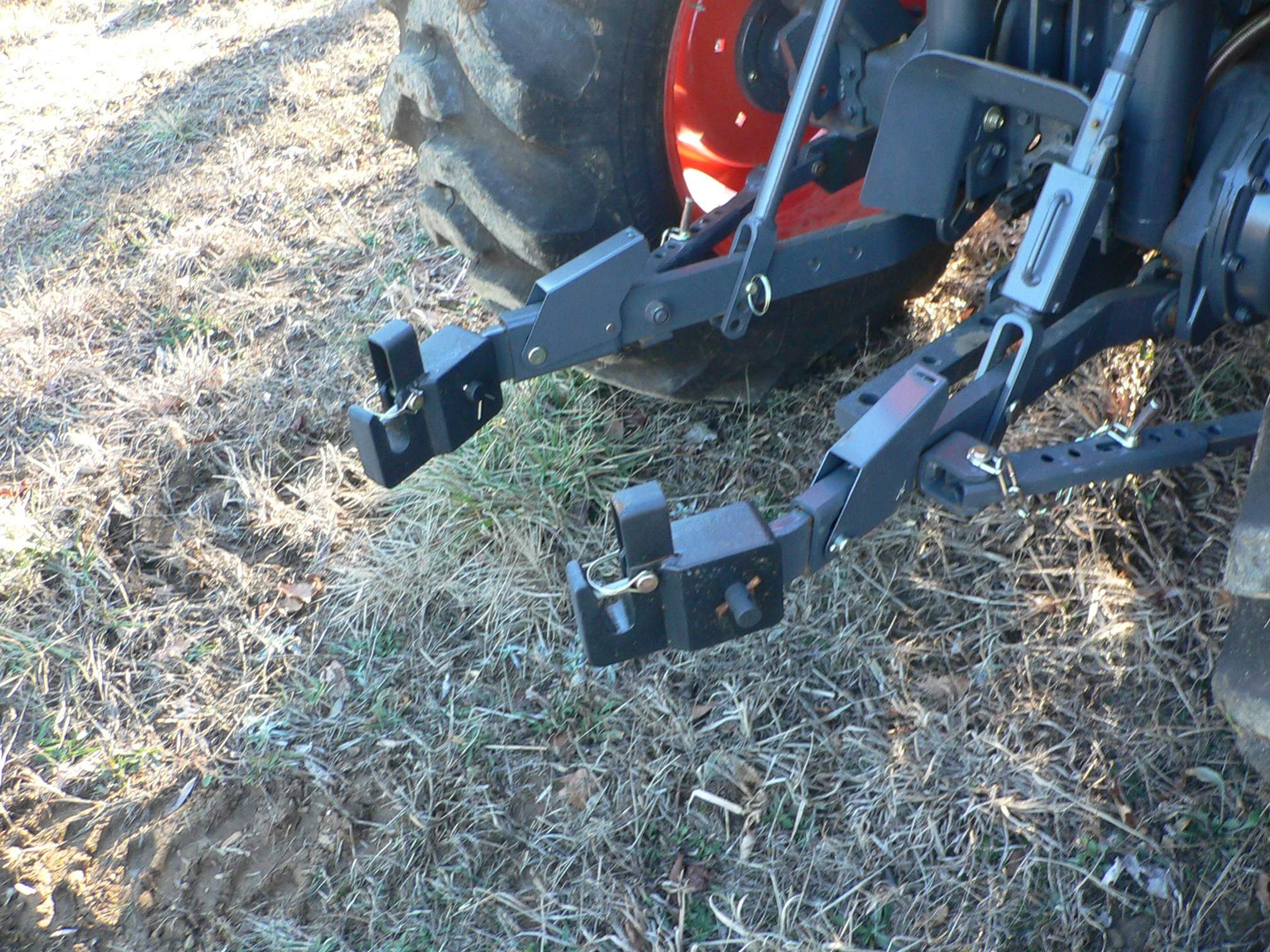

I finally took a picture of my Pat's on my tractor for those that want to see the 2 types I own installed.

If your only aim is easy hookup then the QH hooks win out, however extendable links offer what is needed to proceed with minimal difficulty without introducing any performance limitations. The pictures referred Post 15 above show the problem of unarticulated end links. Move the arms off center or off the setup spacing or to different respective heights and the slots dont line up whereas the balls would just swivel into line. There are certainly situations where the tractor is always used the same way and it is w/i the range the QH can be set up to match. Life remains good until you need the versatility to connect something significantly narrower or wider or to an off center or off level pull point. These instances will at minimum present inconvenient adjustments to the setup in order to accommodate. There will be cases where alternate setups are impossible. Wel-l-l... theres always the tractor without the QH. Life is good...
