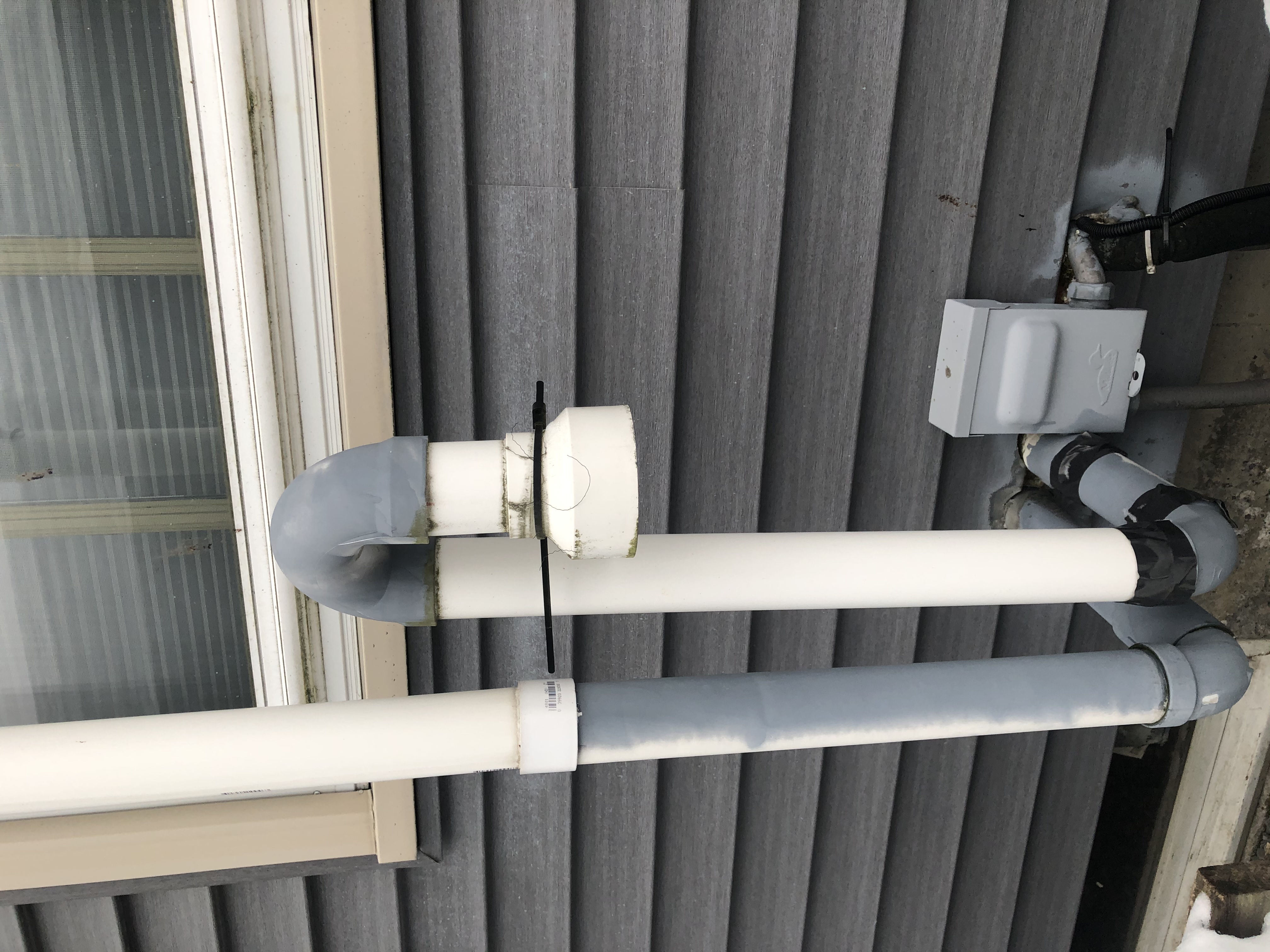

56AB63D1-8CEB-4CED-A0AE-20F2B862F1B1.jpegthrowing this out there for what it痴 worth.....my propane furnace starting giving me problems after about 12 years of living here. It would shut down for no apparent reason in really cold weather (I知 in the northeast).
I found a minute amount of ice crystals formed around the perimeter if the cold air intake outside the house. Couldn稚 really see them, but could feel them with my finger. Evidently that small amount of ice crystals disrupted the air flow enough to shut the furnace down.
I put an adapter on the intake to increase to size. Worked perfect - never had any more issues.

View attachment 686514throwing this out there for what it痴 worth.....my propane furnace starting giving me problems after about 12 years of living here. It would shut down for no apparent reason in really cold weather (I知 in the northeast).
This is a great point. I’ll look at that today. With the extreme cold, ice and snow, this is a possibility.
Thank you.

Ice in burner air intake got nothin to do wid heat exchanger, but real good indicator furnaces workin hard.
Thanks. Filter was changed on January 31, 2021. The tech vacuumed out the inside of the furnace including all around the blower motor. It wasn’t that dirty.
I did look at the PCV intake pipes outside. There were huge ice cycles hanging below the pipe. Broke those off. They went blocking the pipe but they were huge. I guess the steam would freeze as it was exiting.
