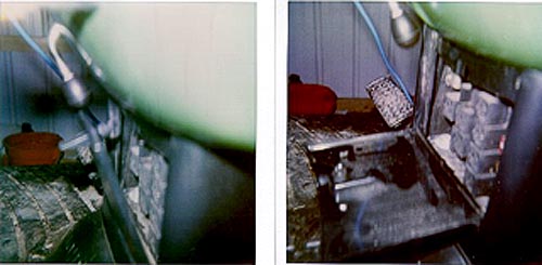

John,
<font color=blue>...By chance, do you have the fuse door upside down or reversed, wrong position...? Think, something logical, something obvious, and something simple... {I can't see it...you can...!}</font color=blue>
Um, nothing apparent yet. The door doesn't come off completely, so no chance of having it upside down, etc. I sure wish you could see it! /w3tcompact/icons/smile.gif I'll go back out and mess with it some more. I think this is an I.Q. test, and I'm flunking it! /w3tcompact/icons/blush.gif
More when I learn more.... this is so weird.. John Deere stuff doesn't just mess up this way, in my limited experience. Who would have thought that this would be my biggest problem of ownership of a new compact diesel??! LOL!

How about some pictures?

<font color=blue>...How about some pictures?</font color=blue>
I'll try. I've never posted pics before, so I'll see if I can get a couple of polaroid shots to come out and scan them in. Yes, this is crude technology.. we are looking into a digital camera soon, but the budget just took a hit from the tractor. /w3tcompact/icons/smile.gif
Here goes! I hope these are clear enough. Two shots, one fully open, and one half shut with the latch in the up position as it would be when open.

Not having a Deere to go look at, I have a question...
It looks as if there's a black plastic fascia around the fuse block. Is that what the fuse cover door snaps into or does the door snap into the fuse block itself?
Is the fascia separate from the fuse block?
What I'm getting at is, if the fascia moved and thus changing its relative position to a fixed position fuse block, this could be causing the problem. Geez, did that make any sense at all? /w3tcompact/icons/crazy.gif

<font color=blue>...I'll bet it's something, you'll end up kicking yourself over... /w3tcompact/icons/smile.gif</font color=blue>
I'm kicking myself, alright!! /w3tcompact/icons/smile.gif
It was so simple, I can't believe it. The handle that pulls up and down is actually part of a bolt, and it goes through a hold in the door. On the other side of the door, there is a sleeve of rubber, and a NUT which can turned to adjust how far the lock extends and how much it compresses the rubber sleeve. It wasn't obvious that it was a nut, it looked like a solid piece of steel with no adjustment. Sigh... /w3tcompact/icons/smile.gif
Thanks for all the thoughts, folks.. I've got it perfect now!
