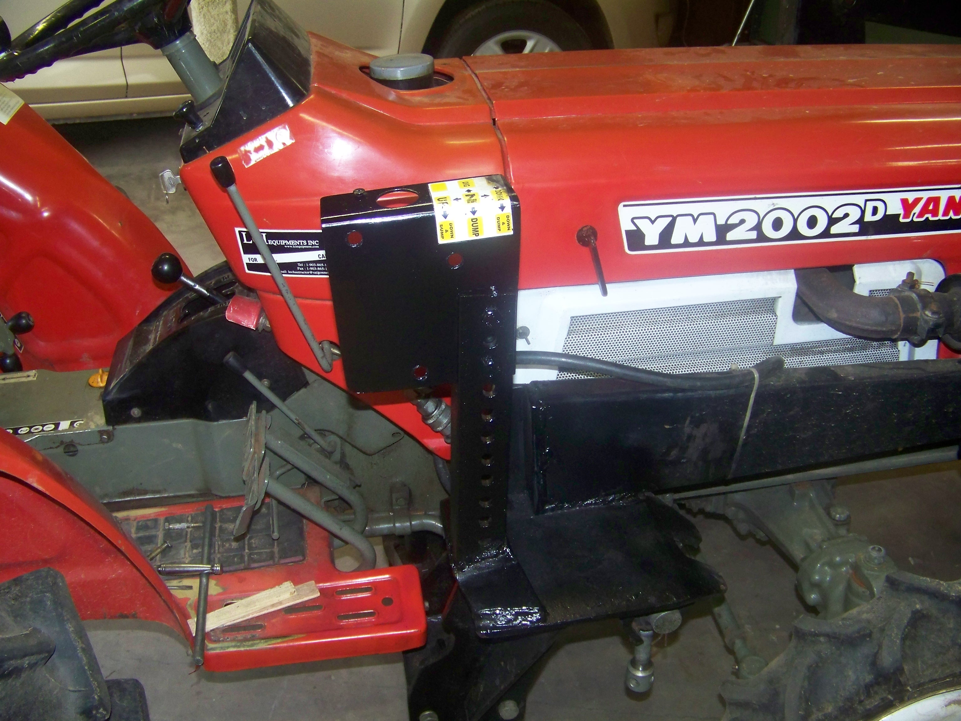

Most factory installed loaders that are quick disconnect the valve stays on the tractor. Therefore the reason for having disconnects on the 4 loader lines. Different manufacturers have different ways on fastening the valve on the tractor. On my old 2002D it had a Bulldog quick connect loader but was not plumbed for quick disconnect. I removed the valve from the loader frame, fastened it to the loader support and added quick disconnects. Looks like your Koyker is a quick disconnect loader. 100_5879.JPG
