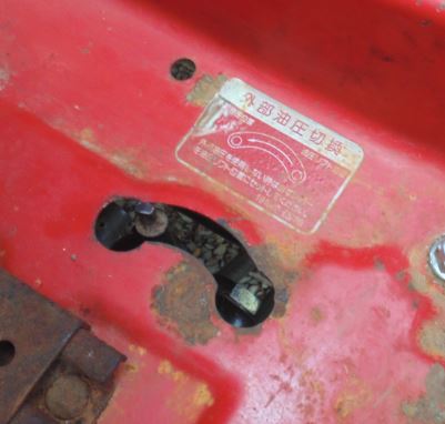

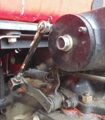

The Koyker loader on my FX28D tractor developed a problem yesterday. Instead of lowering when the joystick controller is pushed forward, the loader now raises. Only the lowering functions fails - all the other functions work (raise and tilt). This occurred once before after I had removed the 3-point assembly to replace orings and a seal. However, the FEL started working correctly after I adjusted the valve held in position with the left 3-point lift arm cap plate. (shown in the pic below). This time, adjusting this control valves didn't help. The 2nd pic shown is a valve control under the driver's seat which also has a significant effect on the FEL and the 3-point lift. Apparently, the these two controls vary the hydraulic fluid and pressure to the FEL and 3-point lift. The hose hookups (pressure and return) to the FEL are routed through the 3-point housing via metal banjo connections. The below seat valve effects the pressure line going out to the FEL. I don't know if this loader lift problem is in the FEL joystick controller or the the two valves described above. Has anyone experienced this problem, and can anyone explain the exact function and the proper setting positions of the two valves ?

have you moved the slide in the 2nd picture. what it does is divert fluid to the connectors under your right foot panel, and that is what feeds your loader control. it does not look like it is all the way in place. when you start the tractor does it seem to be lugging, if so you have that slide in the wrong spot. also double check the quick connects under the right foot panel.
/ FX28D with FEL problem
I've moved that slide control through it's entire range with no improvement. Before the loader raise problem occurred, the FEL worked best with the slide sitting in the far left position - moving it right toward center would stop the FEL from moving at all.

When I started the tractor this morning, I noticed that the 3-point lift was dead - no movement at all as if there was no pressurized fluid on the piston head. But, back to the FEL problem....
I temporarily replaced the return hose from the FEL control with another hose and routed it directly to the opening to the fluid sump (used for adding hydraulic fluid). Started the engine and checked the FEL - it work perfectly, up and down. Apparently, there is a blockage somewhere in the return line. So now, I left with finding the blockage and determining what's happeded to the 3-point.

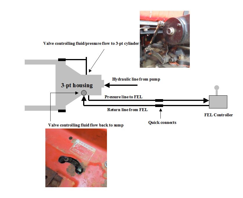

I have no idea just how you are plumbed. Is your loader valve using a power beyond? Does the fluid go through the loader valve before going to the 3 point?

Confused... I'm not sure how your tractor is plumbed either. I follow what you are saying but a flow diagram would be helpful. Sounds like an O-ring or seal is out. Or could be a flow problem to do possible linkage with that lever if there is linkage used with it? I don't know. Can you feel fluid running through the hoses when manipulating the joystick? And like Winston asked, do you have PB?

There is no service manual in English for the FX series tractors. With my limited knowledge of hydraulic systems, I can only show you how the hydraulic flow appears to be plumbed based on my experiences in dealing with the problems that I've presented in this forum. The diagram below shows the fluid flow from the pump to the 3-pt cylinder head cap plate. The pressure flow to the FEL is routed through the 3-pt housing and out to the FEL. It appears that the FEL problem is caused by back pressure on the return/suction line. I've removed and checked the lines and couplings from the 3-pt to/from the FEL and found no constrictions. I suspect the problem may be in the below seat valve on the FEL return line. There are several valve assembly modules on the 3-pt housing including a somewhat elaborate module (36 parts - o rings, springs,etc) bolted to the base of the housing when it bolts to the transmission - only God and manufacturer know its functionality.

Strange plumbing to me. I am wondering what would happen if you disconnected the loader at the quick connects and looped the quick connects together. That would get the loader completely out of the equation and just assure the 3 point is operating as intended. Or not?
A first for me to see the valve you are saying controls flow back from the loader. I cannot understand why that flow should be controlled. Seems to me it should have free flow into the sump.

Yes, I was wondering also. The control sets on top of the 3-point housing above where the return line connects to the housing, and moving this slider control toward center tends to restrict the motion of the FEL. Of course, I'm assuming as to the function of this valve. Until i can get definitive info as to the exact functionality of these valves, I can only assume.

if he moves the slide valve under the seat it stops flow to the loader. 3pt should still work.

Wouldn't the flow from the 3pt which normally got to sump be low pressure?

I am understanding Ben saying the valve restricts flow "from" the loader which makes no sense to me. I cannot see reason to have any back pressure on the loader valve. So which is it, to or from?

I agree Winston, makes no sense. I'm just gonna throw this out there, but would moving that slide cut off some or all of the flow to the loader because more is needed at the 3pt for some odd reason. Or is there suppose to be some sort of auxiliary hydraulics that are suppose to be attached to that slide and it has been plumbed for the loader some how?? Just an idea. Who knows what was done to the tractor before or it is just a really messed up way it was plumbed from the factory.

I originally thought that the slider control effected the pressure line out to the FEL, but after experiencing the problem with the return line, I could only guess that it affected the return line instead. I asked for any help in identifying the actual function of the two controls when I posted the photos - hoping that someone who actually owns a FX28 might have some knowledge or experience in the function of these controls and their settings.

#20
The problem can be laid to rest, because the FEL and 3-pt are now working fine . Blowing out the valve on the return line apparently did the trick. All the discussion lately was simply conjecture on how the hydraulic system was plumbed and why a control was used on the low pressure return line. Anyway, I do appreciate all the input and just hope that the problem doesn't show up again.
