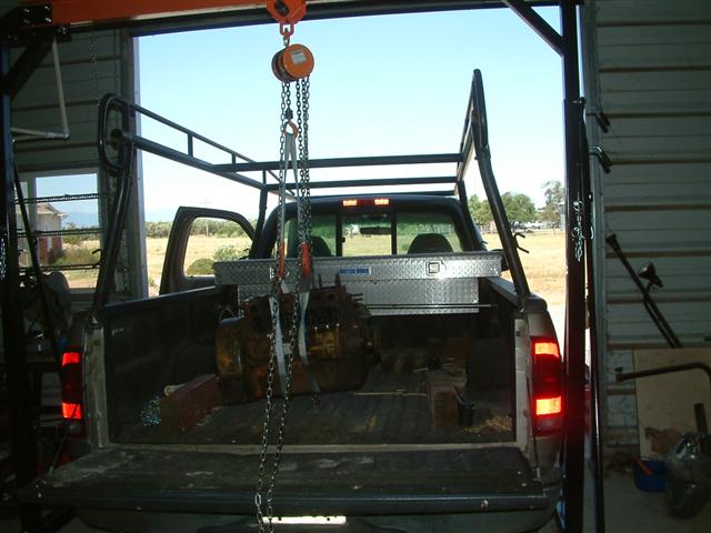

I have one of those $500 HF gantries with the trolley you're looking at. Am using it now in my shop where a 1951 Minneapolis Moline BF is being restored.
http://www.tractorbynet.com/forums/...62478-mid-mount-milimeter-bf-restoration.html
I'm pulling the Hercules engine (27 hp, 4 cyl, gas) in this photo to send to the machine shop for a complete rebuild--no compression on 3 of the cylinders.
You can see that trolley a little better in this photo
I added four sliding outriggers to the crane to keep it from tipping over front or backwards.
As another poster mentioned, I wouldn't try to lift 2 tons with this crane. Maybe 1000 lb.
Also, the plastic casters that came with this gantry are crap. I replaced them with four large metal swivel casters that are much stronger and roll better than the plastic junk.
Good luck on your gantry project.
