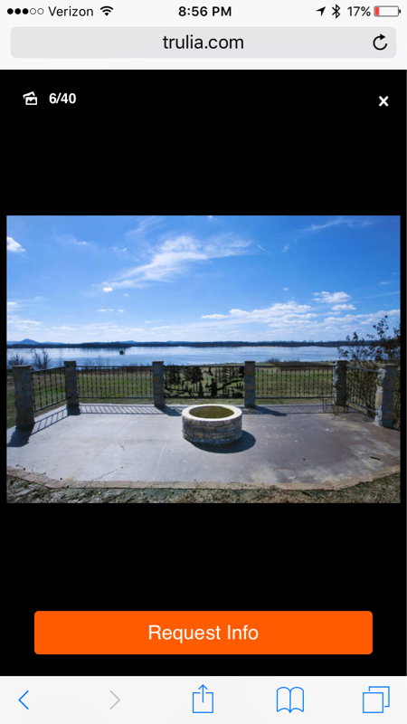

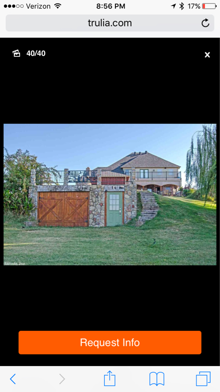

Ok guys I really appreciate your comments. Pictures are worth a 1000 words but I don't have any. I have a offer on the home but have not heard back from my realtor. I have no way of knowing how this bomb/storage shelter was built. It looks like they dug into the side of a steep hill and poured the slab and blocked up the walls. Your guess is as good as mine on the roof but everything is covered except the front which has two swing out barn doors and a metal front door beside barn doors. The barn doors are not sealed very good. On top of shelter they have a fire pit and chairs and it looks out over a river. I don't know how I would get a hole thru concrete top for whirlybird? How would I get vents on bottom? I really want to utilize the space and if I get the property. here are some off the internet image-1694004974.jpg image-1984984143.jpg

Property looks great even if the storage unit turns out to be useless. I would start out by cutting vents in the bottom of the doors. Is the front wall poured or frame with stone facing? To vent it at the top, I think you are looking at concrete work, but that's not a killer if you rent the right tools. I would suggest cutting a good size hole in the top/deck and buiding a small stone or brick pedestal. You can open the sides of it as vents and put a top on it that would become kind of a permanent table.
Humidistat fan as recommended could be used in the top vent. Do you have power there?
