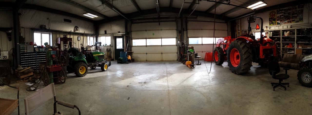

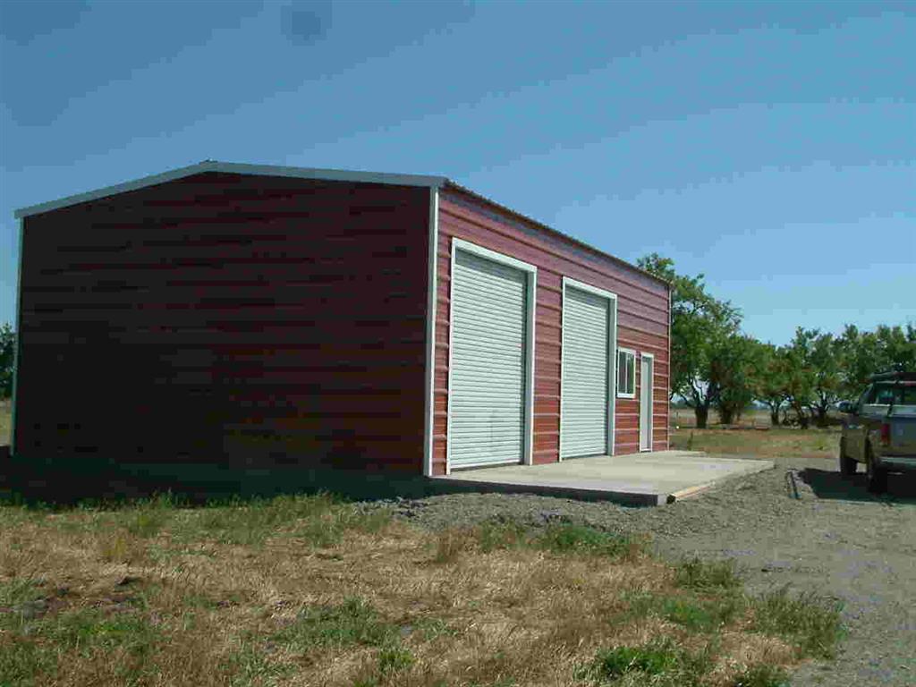

Have you considered an all metal building?? I get by with a 10ft eave building and a 4 post hoist because my building is metal and the ceiling is vaulted by design. Sorry I couldn't find a hoist pic but this gives you the idea.

I like an all metal building. In today's prices, with steel being cheaper, it might not cost more than a wood framed. Good luck

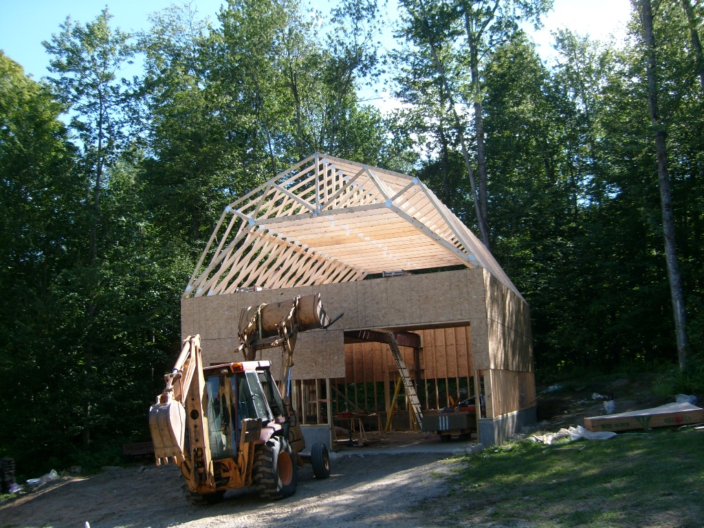

Do you have a size in mind? I built my garage, it's 28 x 32 made from wood, a few years ago. I went with premade trusses spaced 2' apart. I have a Bend-Pak lift in one corner and a steel i-beam running down the center to support the center of the second floor so I don't have any posts in the middle of the first floor. I probably have $18k into it. I'm sure if you downsized it you could save quite a bit of money. The 32' I-beam was over $1k alone. I think the 28' wide x 12' high trusses were $2200 for 16 of them.
