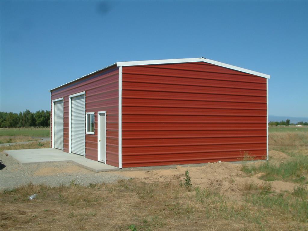

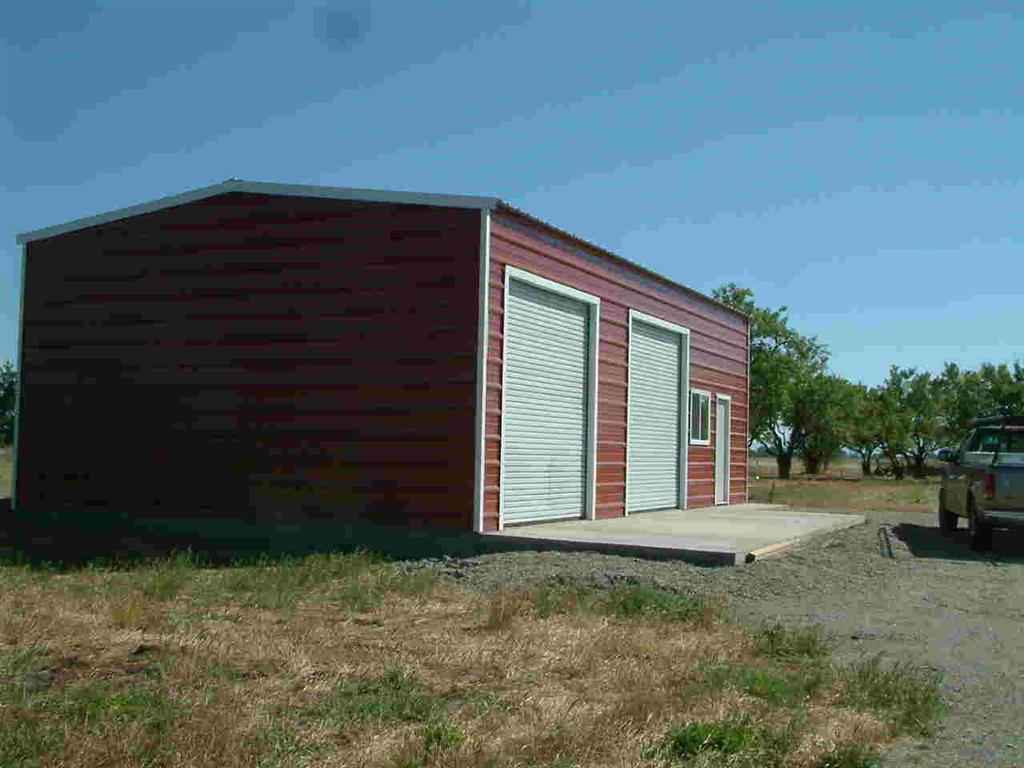

My shop is a 24x42 ft steel building of pretty conventional design with two 10x10 ft rollup doors and 12 ft wall height.
With 6" concrete floor (4000 psi concrete), cost was $23K in June 2005 when it was built.
That looks like what I want. Have to build a house first though.
Does the $23k include any plumbing/electrical/heating/partitions/etc.

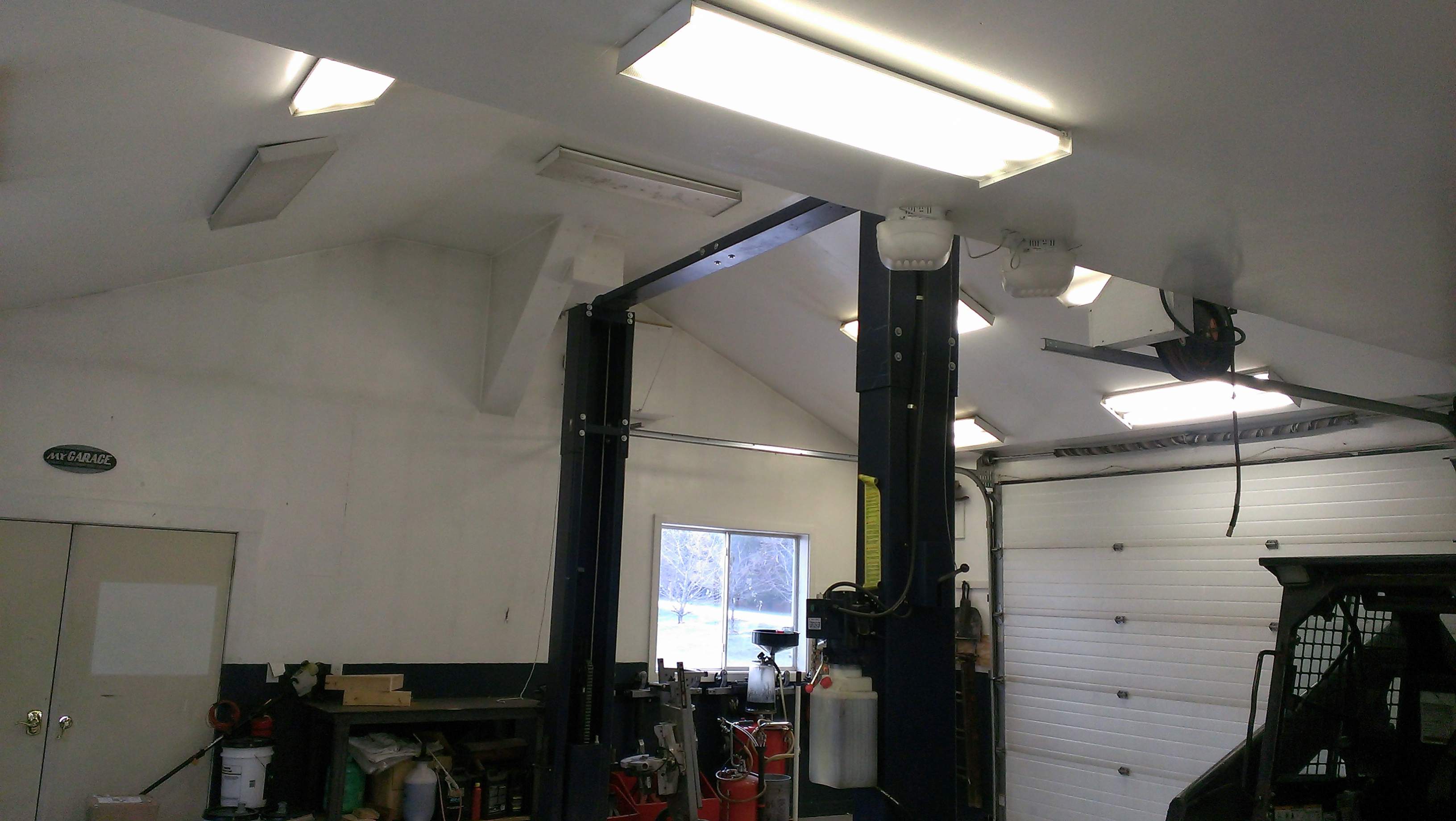

The wall are 10' door is 9' rafters where the lift is, standard 28' truss on the rest. Stick framed on monolithic slab. Can put suburban on almost lift it all the way. Regular car no problem. 24" over hang all the way around. Did it this way, because you can see it from the house and didn't want monstrosity. Also have to heat it.
This is the same as the setup I was talking about / have. My lift fits in with about 6" to spare. No complaints. Makes the garage much shorter and less imposing. From the front, it's a 2-stall garage. Its actually 5 stalls with a full height lift. Be careful not to hit the garage door though!! I've come within an inch or two once. NOT cool.
Nope. I did the electrical wiring myself. No plumbing, heating, partitions.

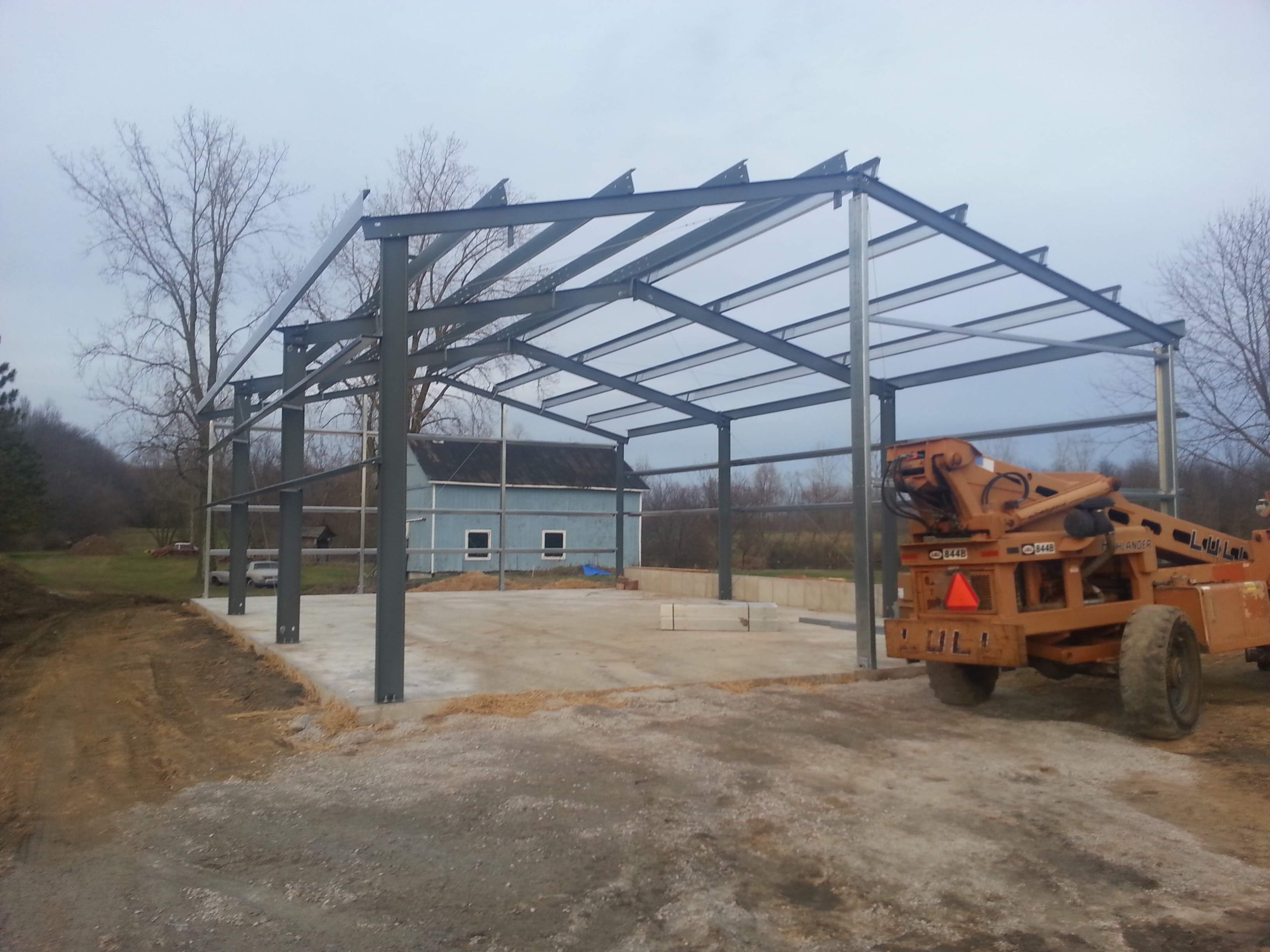

here's mine on the way up.
Cool. Start a thread with pics all the way thru. Similar to mine but smaller. I really like mine. The vaulted roof allows me to have a hoist in a 10' eave building.
