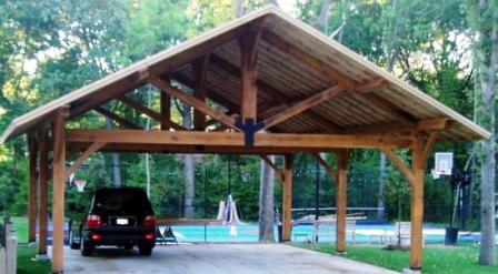

I agree about the trusses. At least do a gambrel or something that gives you some added storage.
I really like the timber frame, myself. It might cost more for the raw materials, but it uses less wood in the end and you don't need to have a crane to put them up.
