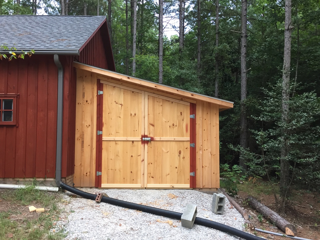

I am looking to add an enclosed lean-to onto an eave wall of my barn to park a car in. Been grappling with some decisions and tradeoffs and feel like I need TBN input.
In order to make this project "sane" and keep it to a short timeline with minimal disruption to the main barn, I want to have the new lean-to tuck under an existing eave and not disrupt the current roof or make my framing complicated. I have 10' of clearance under the eave. I want to make the lean-to 12' or 14' wide. Ideally I want a 9x7 garage door centered on the gable end, but do the math with minimal 2:12 or 3:12 roof pitches and framing (2x8 or 2x10 rafters depending on pitch and width) and there just isn't enough interior height to get a 7' tall garage door in there with the track and hardware even if I go with a low-headroom setup.
I've looked at this every which way and a 9x7 garage door just doesn't look doable unless I go with an even shallower roof pitch and I think that's a bad idea for shedding water and handling snow in the winter. Only other recourse is make custom swing-out doors, which is what I did on my other lean-to (picture below). Those work fine for day to day use of the barn, but clearly won't be as efficient as a garage door with power opener when it comes to pulling in with a car.
Anybody think of a better solution? I have also considered making a totally new structure that doesn't have to tie into the barn, but that has it's own set of disadvantages. I like the lean-to idea because they go up quick, cost is minimal, and I can easily tap into electrical power from the barn for lights, door opener, etc.

Picture: existing lean-to on rear gable end of barn.
3:12 Roof pitch. 12' wide.
8' wide door opening.
Doors opening height ranges from 7' to 9'.

This new lean-to needs to go on one of the eave walls of the barn. That previous one I did went on the rear gable wall, and due to the slope of the ground, I gained ~16" extra vertical by terracing the lean to down below the barn floor (look in the photo and you'll see the extra skirt boards on the back of the barn). That was somewhat of a unique situation I think, otherwise I agree with you about extending that gable end roof.
