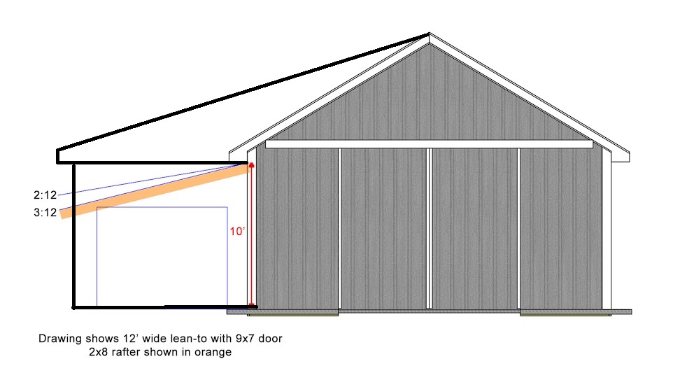

eddie already said it when i read this post this morning. abandon the lean to. instead of extending the roofline- just drop down a foot and add on roof so you not touching the original roof and build out. it might cost you a day or two to do the gable instead of lean to but it wont disrupt anything and solve door issues.

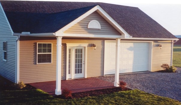

Explain more!
https://www.amishshedsfredericksburg.com/wp-content/uploads/2017/07/3-4.jpg
The gable can be any size to allow for your door. And you will have the ability to maintain the roof slope you need.
You can also extend the gable off the roof, making any size porch area over the entryway.
A shorter extension over an overhead door can add a very nice look, if you are interested in aesthetics.

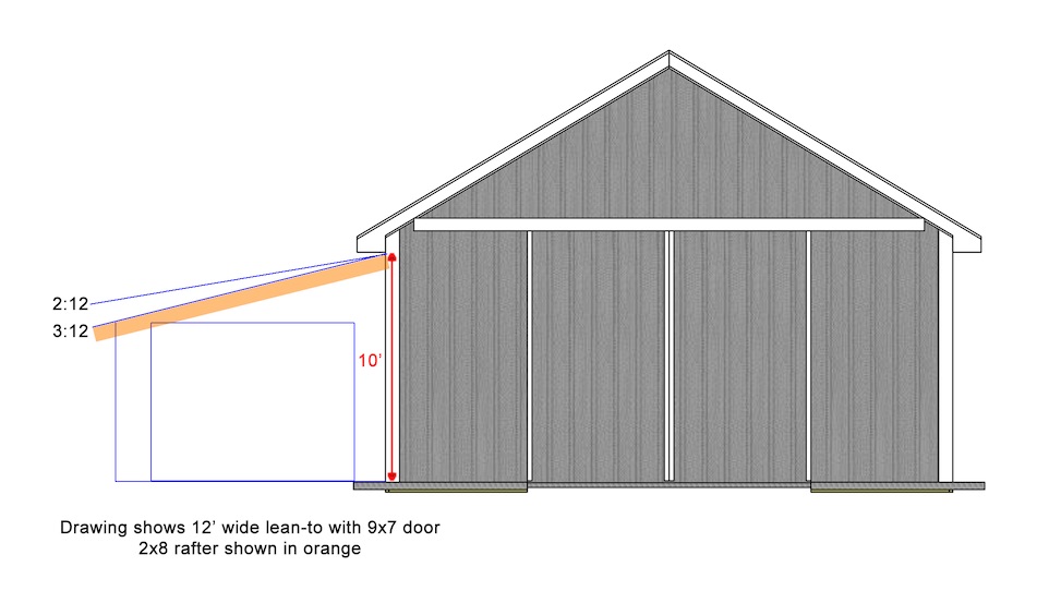

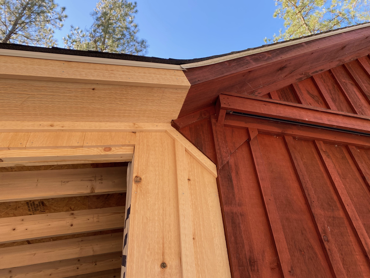

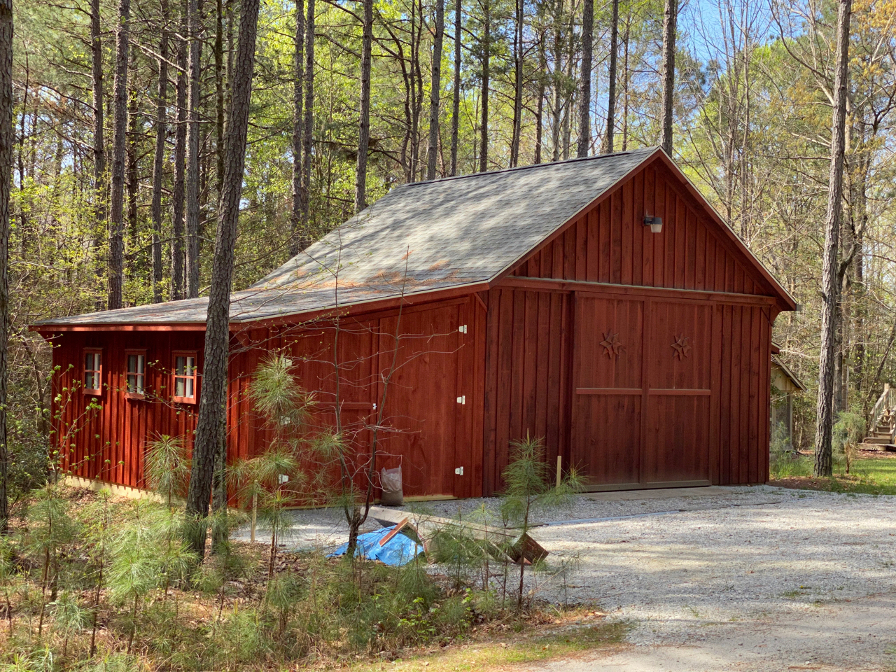

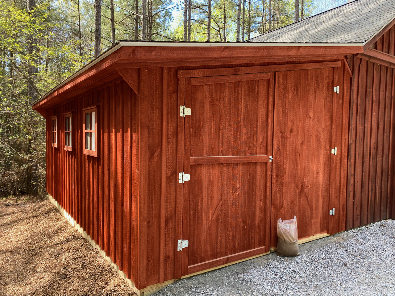

I am looking to add an enclosed lean-to onto an eave wall of my barn to park a car in. In order to make this project "sane" and keep it to a short timeline with minimal disruption to the main barn, I want to have the new lean-to tuck under an existing eave and not disrupt the current roof or make my framing complicated. I have 10' of clearance under the eave.
I think I misunderstood when I first read your post. The picture is of your barn with a lean-to that you have already added to your barn? This is not where you want to put the garage door and park your car.
You want to build another lean-to off of the existing garage to the left of the new lean-to, coming out forward from the barn?
You want the roof of the new lean-to to tuck under the existing overhang of your barn and come forward?
The wall is ten feet tall.
If I now understand what it is that you are wanting to do, my suggestion is still to abandon the lean-to idea and frame your walls the same height as the existing bar so you can have a full sized garage door. Then to keep your framing simple, run your roof from the peak of your existing barn, down to the farthest wall in one continuous slope. Technically you don't have to remove much of your existing roof or shingles, just enough to attach your rafters. Then deck the rafters and install new shingles on the new roof.

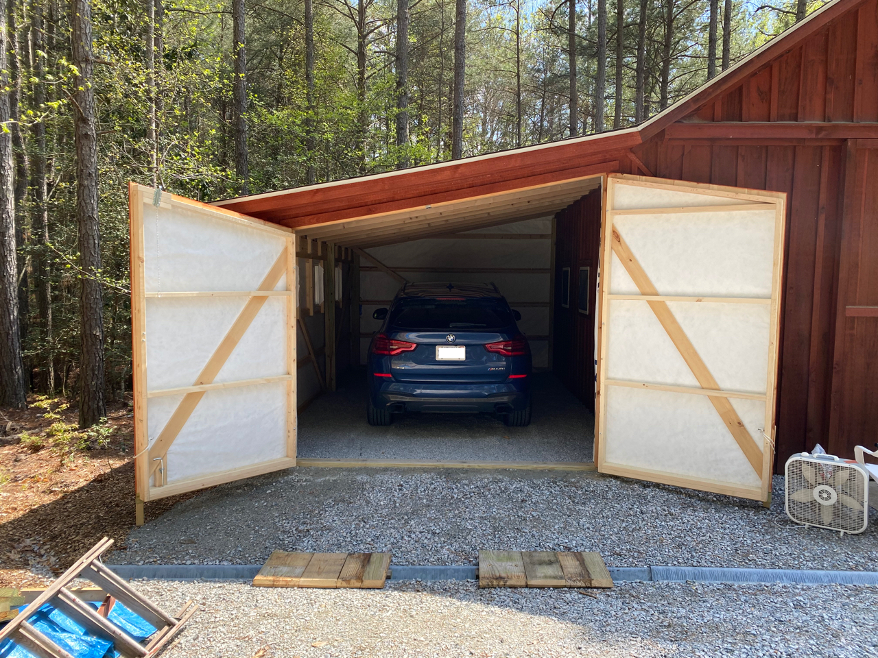

To answer Eddie's and other questions, here's a sketch that I should have uploaded to begin with:
attachment.php
That shows what I was hoping to do but what I'm up against for overhead clearance.

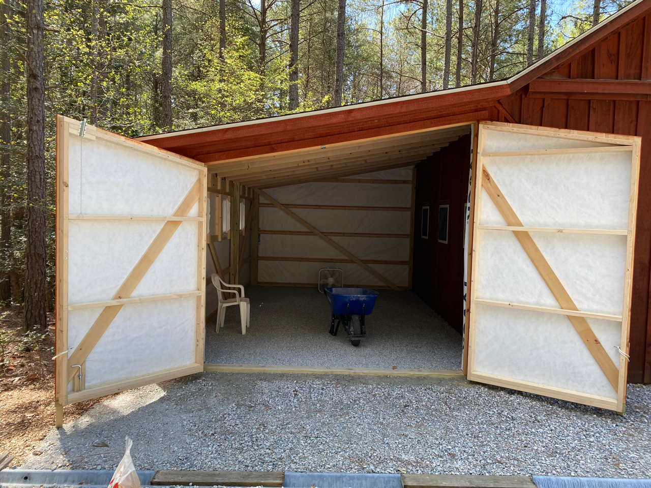

It seems that if I can do a bi-fold door that opens to the outside, and power it, that would take care of the issue. I found some solutions rigged up using standard garage door chain openers (including a thread here on TBN) that look doable.
For that matter, two standard out-swinging doors would work to, if I can power those, and I think that's also doable by rigging a custom setup using a standard opener. I suspect gate openers would work for that too.
I would consider making a whole new shed roof that takes off from the main barn roof, higher up, but that will take a bit more work than going under the eaves. I guess I need to factor in time/cost taken for custom doors and openers versus using standard garage door.
