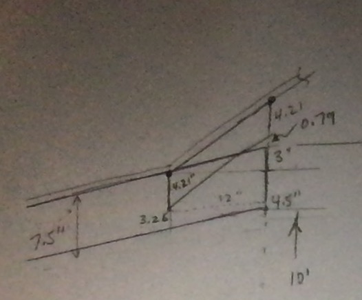

I would abandon that lean-to idea and extend the existing roof line instead.
I looked at that, see attached sketch -- would have run 2x8 rafters up into the barn eaves next to existing truss tails. Then tied them to the existing header with rafter hanger brackets. Had all the details worked out and it looked doable with minimal disruption, but in the end it only bought me about 3-4" of extra clearance! Not enough to really help to make it worth the trouble.
The only way I can truly get as much vertical clearance as I want would be to tie the lean-to roof into the main roof up above the eaves -- the lean-to roof would end up coming off the main roof like a shed dormer. But that gets complicated as I'd need to work out the framing so that the new rafter loads transfer down onto the existing trusses and the wall header in a reasonable way. Generally you can't put a point load on a truss like those rafters would cause without reinforcing the truss.

How about putting in a shorter door? How much clearance do you need for your car? Not many cars are over six feet in height. On the other hand I managed to put in a door and operator with four or five inches of clearance to the ceiling. You will need to use some ingenuity and do some light welding. When my door opened, it had about 1/4 inch clearance to the ceiling and then sloped down to provide more clearance. The bar and sprocket was attached to the ceiling rather than the header and the pull rod was five or six feet long. Worked fine for the few years I lived there.
What happens if you go to 2x4s and beef up the roof system, sort of half-truss? Does that yield the clearance?
Second thought would be to alter the stock door height if possible.
I could go to a 6' tall door at greater expense (I guess it's not standard like 7') but long term I see that as being a bad idea since I could never get a truck in there, or even my UTV. I really would like this space to be versatile for future uses. Another option could be taking a 7' door and remove about 6" from one of the sections to get the overall height down, then combine that with a low headroom kit (which saves 6-8" depending on who you believe).
