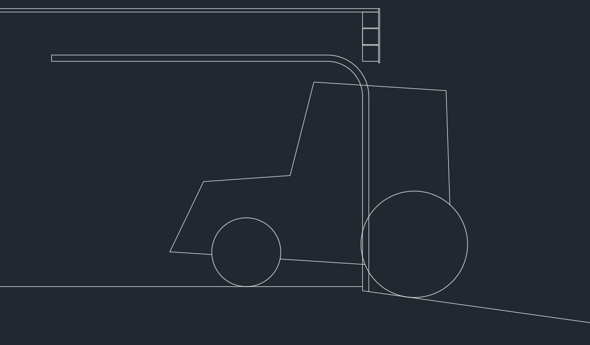

Well, The RK spec brochure appears to be spot on regarding tractor height. Took my tape measure and came in at just under 100 inches.
I also took some other dimensions so I could sketch up the rough tractor profile in AutoCAD. Turns out, the angle of the driveway is not as big a concern as I initially thought.
Looks like I should be fine with 9 ft doors. Just a heads up in case anyone else finds themselves in a similar situation.

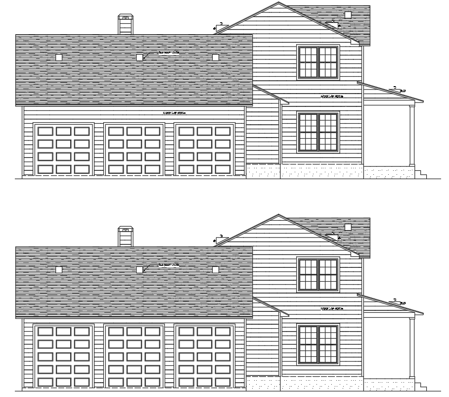

A valid point, one I've considered. Here's a pic with 8' vs 10' doors on our garage. I don't think the 10' look too bad. My beef with the 10' doors, aside from the extra cost of the block work, is that if I can ever afford to build a 30 x 40 steel shed, the tall garage doors won't be necessary. Really, I only need one to be that tall, but I would do all three for symmetry.

Perspective drawings can be deceptive. Believe 10 ft doors will cast a commercial appearance to your home. 9 ft should be more than adequate unless you see yourself purchasing a much larger tractor.
My vote is for the 10' doors.
The way they are building new trucks, it won't be long you'll need 12' doors.
You have to look to the future, you never know what's a head.

Looking at your drawing it looks like the only change is in the door header and height. That would be a tough call for me.
