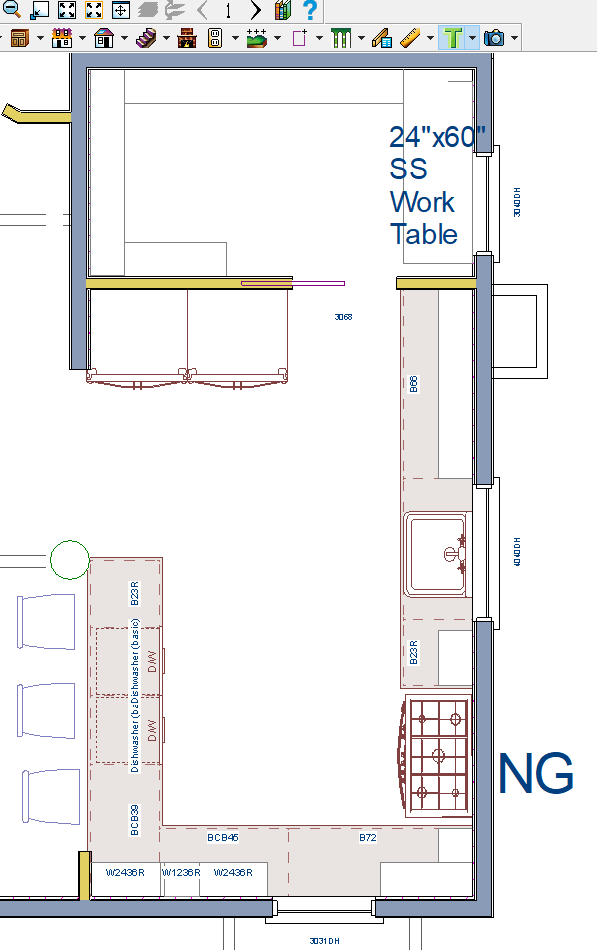

I'm working on a long term remodel of my house where I'm making the back of the house, the front of the house. The current kitchen is OK, but it's in the wrong place. I'm also converting my attached workshop/garage into a Great Room. We want the kitchen to be part of the Great Room so everyone can see everything regardless of what they are doing.
This is the plan that my wife and I have come up with for the kitchen. It will be open along one wall to connect to the Great Room. We want 2 refrigerators. We thought about a commercial fridge, but don't want to pay for it when two fridges will give us more options. Neither fridge will have a water dispenser. They take up too much room. Our current fridge is a LG that we really like, so we'll get another one, and have them next to each other. https://www.lowes.com/pd/LG-25-5-cu...tproof-Stainless-Steel-ENERGY-STAR/1002543648
We also want to have 2 dishwashers. We have 6 dogs, and they are fed twice a day. Some of them get two bowls of food, so it's normal to wash 18 dog bowls a day. My wife is a little crazy, so she washes the bowls after each feeding. It's so bad that we'll have dishes in the sink because the dog bowls need to be cleaned first!!!!
She wants a gas stove with six burners, so we're going to get one that's 36 inches wide. I'm not 100% happy with it's location in the corner, but it will have counter space on both sides, so it's a doable compromise. The sink will be as big as we can get one. She's just recently decided that she wants a stainless steel farm sink. Counters will be granite.
There is 7 feet of open space between the cabinets. Not enough room for an island, so we are going to get a 5 foot long stainless steel table on wheels and keep it in the Pantry most of the time. Then wheel it out when we need it. She likes to can and we're going to start grinding meat for dog food, sausages and ground for ourselves. That will all be done on the stainless steel table.
Floors will be tile. Walls are sheetrock and ceiling will be tongue and groove with exposed beams and as much height as I can get out of it and still have good insulation.
There will be plenty of outlets, and lighting. Otherwise, it's a pretty basic design.
I'm currently building an attached three car garage so we can get everything out of the shop. Once that happens, I'll be able to start working on the Great Room, and the new Kitchen.

Sounds great. For the dog bowls, you might look at a bar dishwasher, if it is big enough; they only have one level. Very rapid cycle times, with sanitizing rinses make them great for food service uses, like cleaning meat utensils, and, say, dog bowls. It doesn't dry, but you just pull the rack out and toss a new rack in.
I worked one place where there was an eccentric guy who had two dishwashers; both with magnetic labels that flipped from "Clean" to "Dirty". He never unloaded the dishwashers. He used them to store the dishes, grabbed clean ones from the "clean" dishwasher and put the used ones in the "dirty" one until it was full and the cycle repeated. It seemed very sensible to me, but the consensus view on him was that he was brilliant but a few cards shy of a full deck.
If it were me, I would move the stove out of the corner. I have never been in a kitchen with a stove in the corner that I found that I liked, as it is so cramped to have the counter right at the edge of the stove. You don't have much room to maneuver, and the cabinets get in the way. You also lose all the under cabinet space in the corner where you can normally put a lazy-susan, or pull out storage, though it isn't a bad place for an electric hot water booster tank. Our current house was built by the prior owner, who originally put their stove in the corner (adjacent to the sink!), and then sometime later moved it ten feet down the counter away from the corner and sink. Two stove vent ducts through the roof, and two gas outlets. (The old gas line wasn't even capped! Shutting a drawer could have opened the valve. Sheesh.)
One advantage of commercial stoves is much higher BTU ratings, if that is of interest. The downsides are cost, that the hoods have to be larger and venting has to be more powerful.
