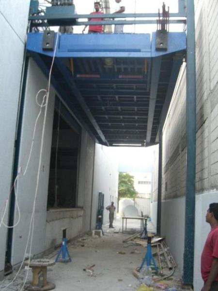

Here is a photo of one of my lifts being tested it is an 8 ton lift with 20 ft of rise note we have more than 20 tons loaded on the platform
This is metric tons by the way

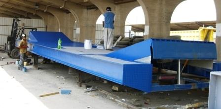

Some of my lifts are very special purpose
This one has dock levelers on both ends and is over 40 feet long

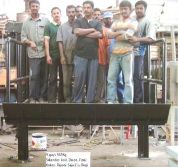

but some are tiny only capable of 2 tons

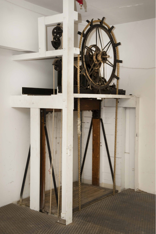

This is like the lift I described above.
Dean,
We have an old blacksmith shop near me that uses one of those, but the platform is big enough to put an entire carriage on to move it to the second floor for storage. I think it had knots in the rope, but wouldn't swear to it as I haven't been in there in over 40 years.
