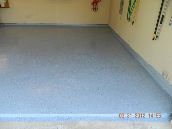

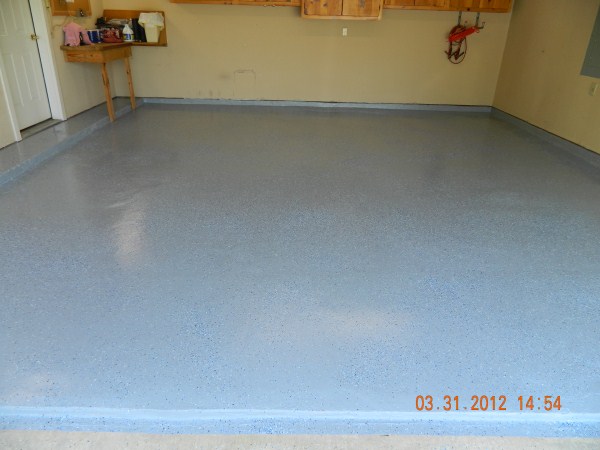

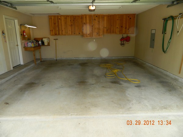

This is my latest, and hopefully last, project before the really hot weather arrives. I'd never heard of RustOleum Epoxy Shield garage floor coating until a daughter and son-in-law did their garage floor with it. There are two colors. They used the tan and I used the gray. Day before yesterday, I moved everything out of the garage, yesterday son-in-law came and helped me scrub, etch, and rinse the floor. Then today he came back and we applied the coating. First picture is obviously the "before" picture and the other 3 are today. Has anyone else used this stuff?

I used the tan about two years ago and it seems a very good product. Obviously with any coating, prep is key. I'd use it again.

Looks real good Bird:thumbsup: Cant tell from the photos, but I know on some floorings you can add a slip resistant granule or "chips" to add some slip protection.
I use a product called "Shark Grip" for ramps on store approaches and on some occasions even fine sand or glass beads, ends up like 100 grit sandpaper .

I've had it for about six years. There's some chipping just outside the garage door where it's exposed to the elements (I don't think it's intended for outdoor use), but otherwise it has held up very well. I would definitely recommend it.

Looks fantastic Bird..
