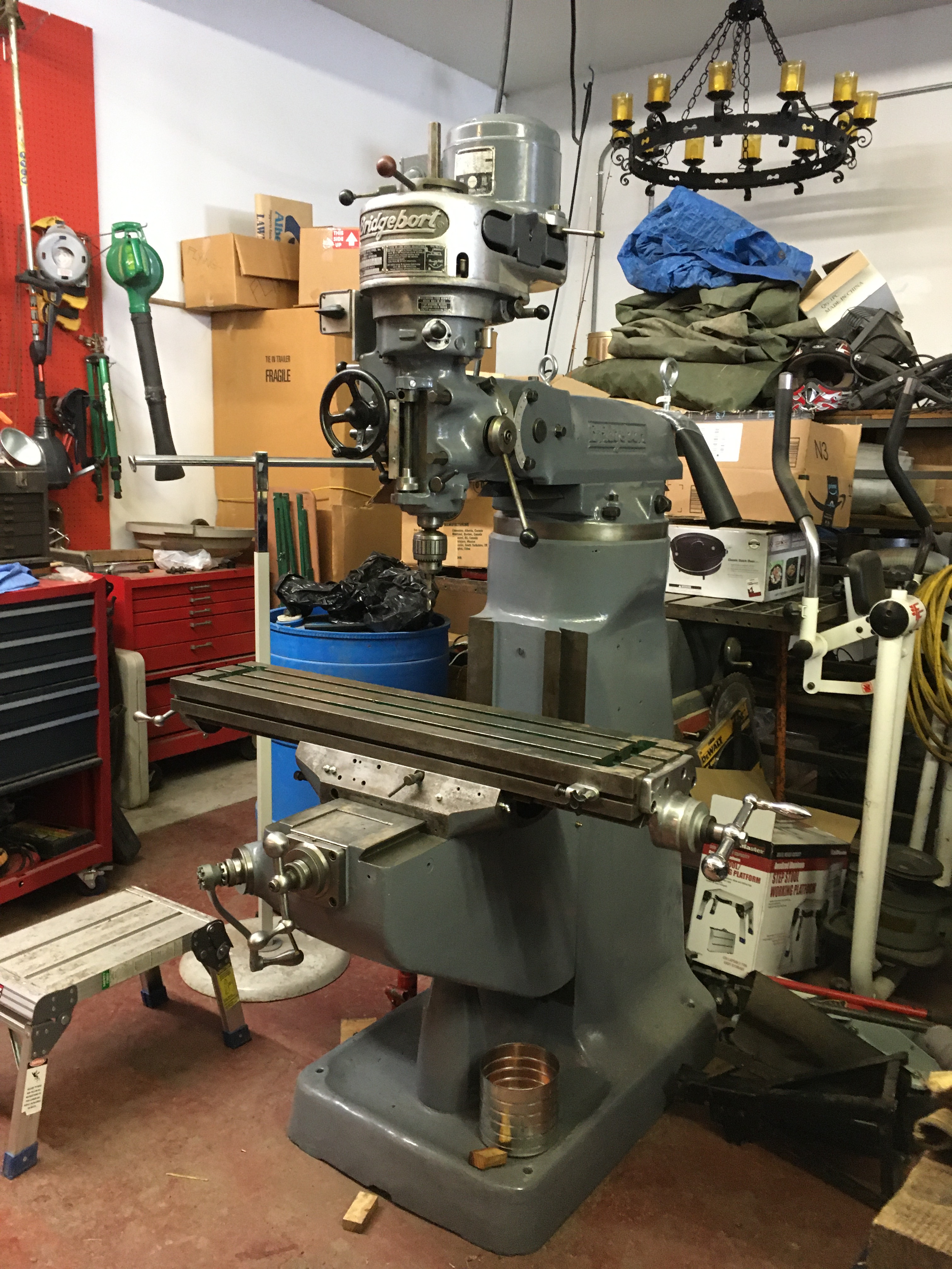

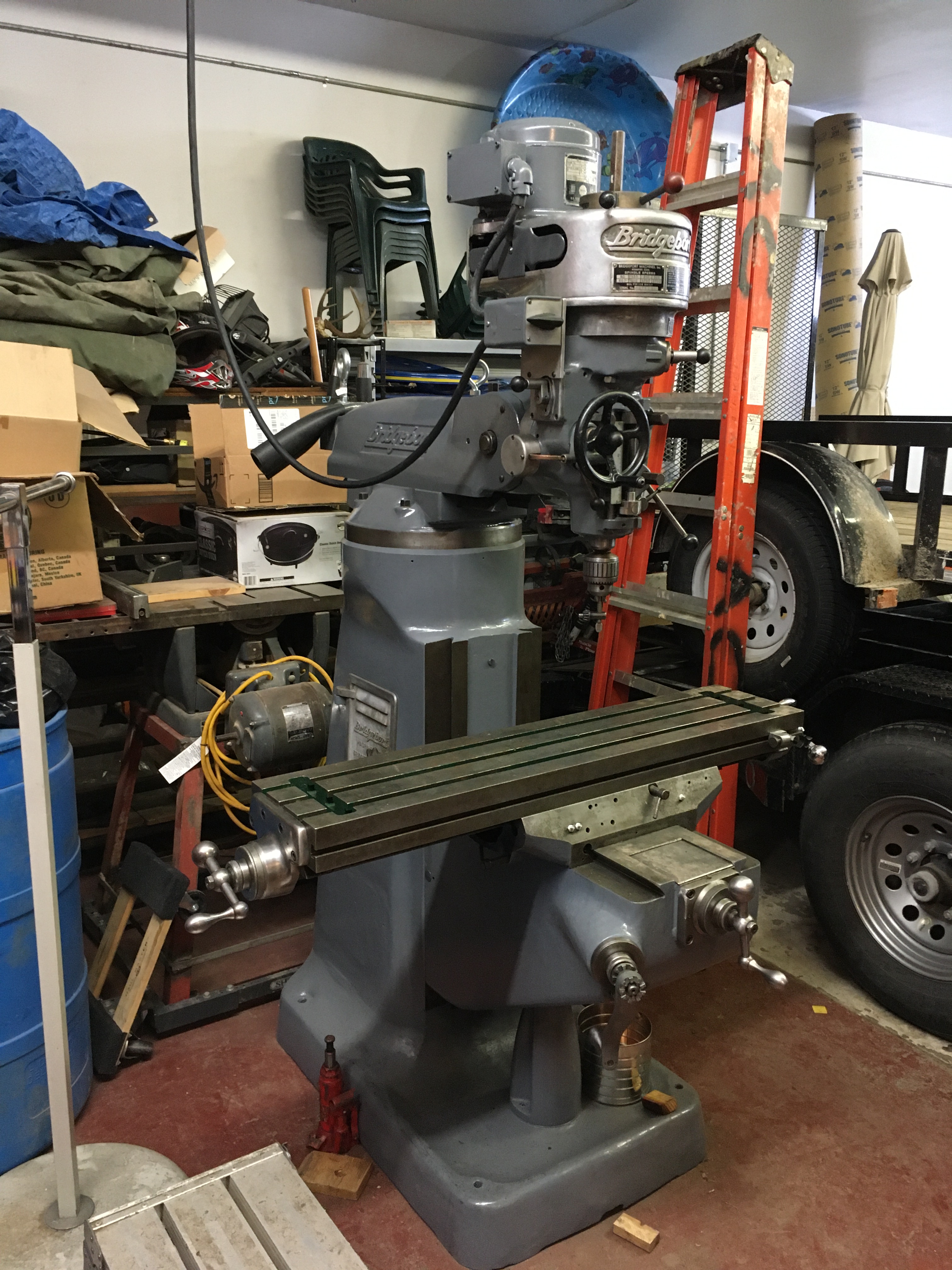

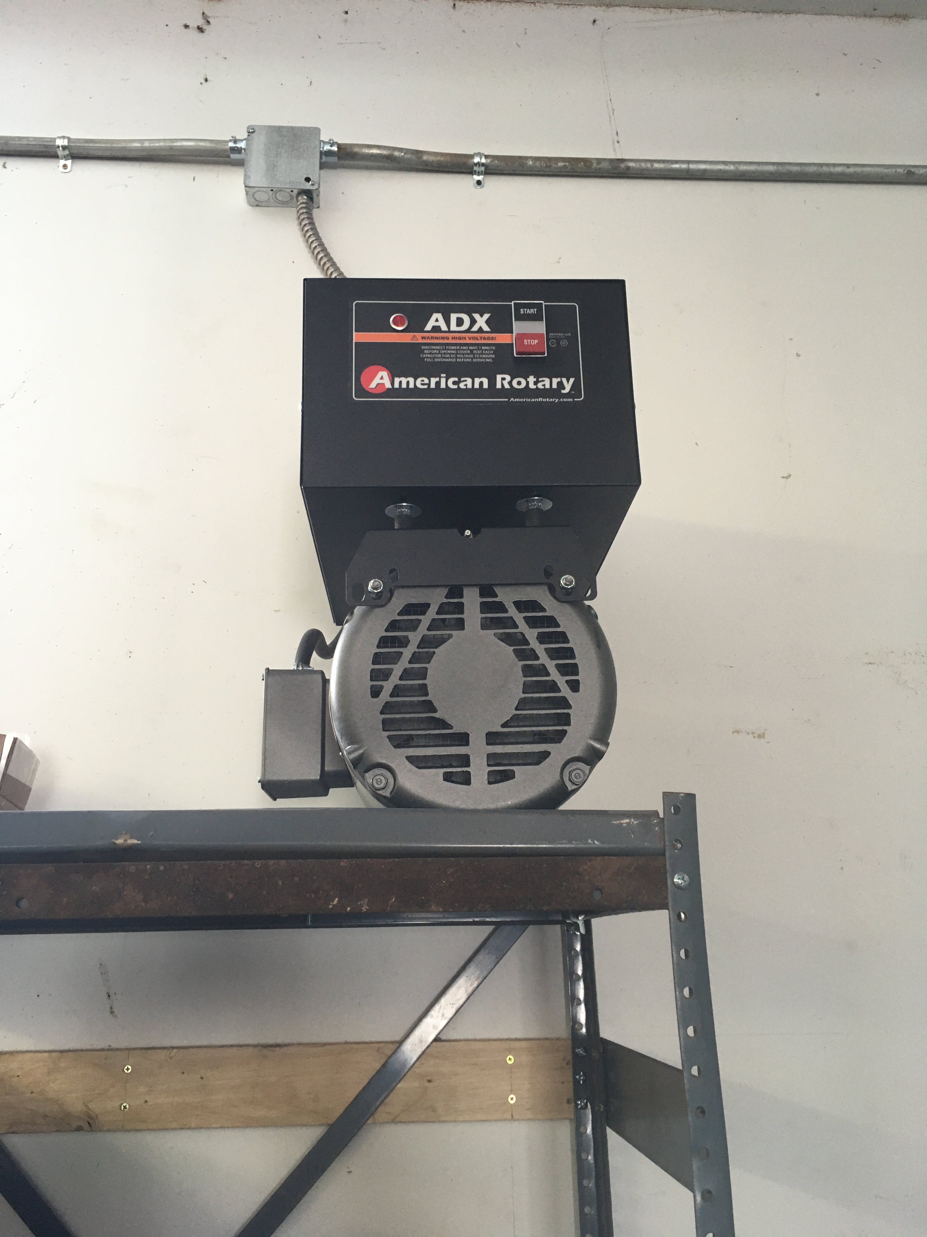

Thought I would give an update on the Bridgeport knee mill rebuild. I started this project about a year ago, finished it a couple weeks ago. I also had to put in a phase converter so I had 3 phase power to run it.
I still have a few detail things to do on it but for the most part it is done and ready for use.

Gee that takes 3 phase, 440 volts? So you have 240 volts in the shop, (and appears to be a crowed shop) then you run a 240 wire wire to a motor that some how returns it to the mill at 440 volts, how far of the wagon am I........
Great pictures thanks for the update, so do you have any first projects on the list? I suppose the where this Bridgeport shines is making gears and splines.....
Most 3 phase motors can be wired for 480 or 240. Re-wire it for the lower voltage and all you need is a phase converter.
