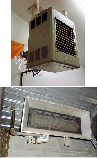

I have one of those heaters, or one like it in the lower level of my shop. I have used it once when I first installed it! Seemed like a waste to me, but it was free so I hooked it up. (see attached photo) The heater in the top photo is what I use in the top floor of my shop. Puts out 65k BTU's and cost only $50. It cost me more to convert it to electric pilot! I keep the heat at 45F. to keep anything from freezing, plus the tractor starts better if its a tad warm!

I'm sure that a lot of folks are tickled with the infrared heaters as its just a personal choice. The same kinds of choices are presented to us with our tractors, manual, shuttle, hydro, and so on. I'm merely saying that I had and used an Infrared heater for one full heating season before changing the game plan. If you are interested in a rather inexpensive and economical heat then the Infrared unit may suit your needs. You be the judge
