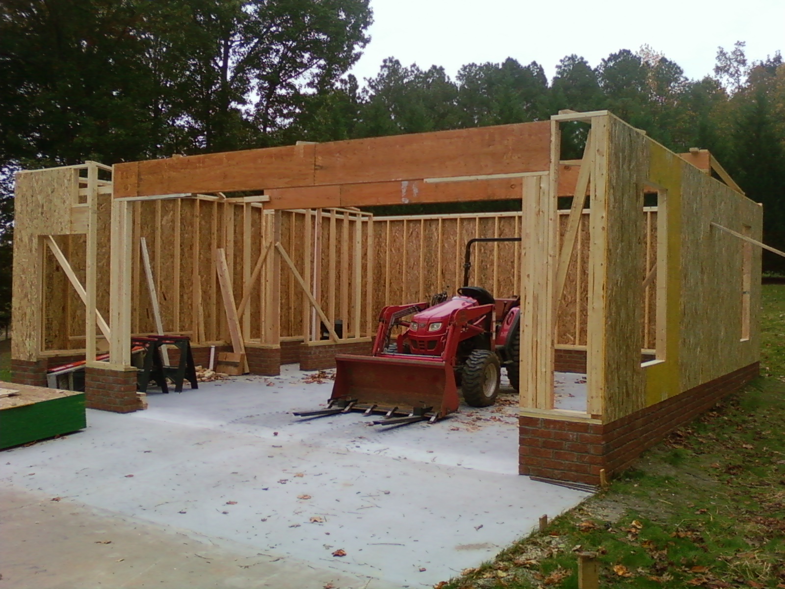

#66
Making progress. Got some help for next weekend. Hope to get it dryed in.
