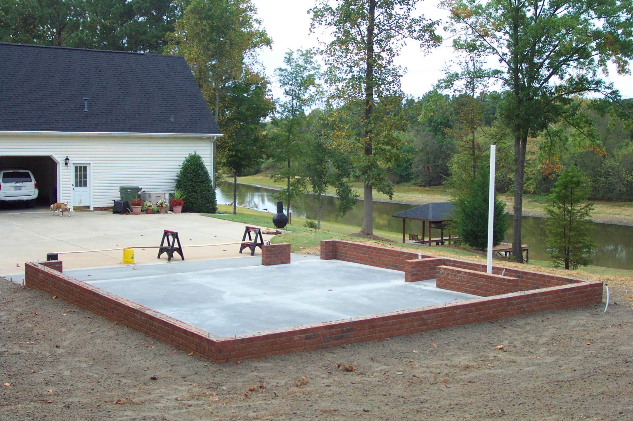

I've never seen it turned up the wall. I think it would be a PITA. Just butt it to the wall. The finishers will want to snap a line on the brick that they will float the mud to. It would be hard to see and get a nice level floor at the walls if they had to fight the VB in that local. You might want to tape some over the wall and ductape it just above the chalkline. If you don't cover it some way, it WILL get mud splashed up on it.
I am unaware of any code section (IRC) that would require a expansion joint it in that location. It's done that way 99% of the time here. I've inspected 1000's of them done that way. But. it's always best to ask YOUR Inspector about the lack of a expansion joint if you're concerned about it. WDO
   / Garage project
#52
Cool, I will. I was thinking the concrete might bond to the brickwork around the sides without some barrier.
   / Garage project #53
It will bond to the brick & block in some spots.
I'll digress to the building inspector, but leave you with this. I do install perimeter expansion joint in a garage. It's really almost invisible and what it will do is expand slighty when the concrete shrinks during drying phase.
This will keep you from having an open crack next to your block walls. That crack is a great place for bugs, crickets, spiders to hide. Once the white foam has been troweled over, you can't even see it. It's also a great "guide" for your concrete guys to follow. Much easier than a chalk line.
   / Garage project #55
Using no joint will allow the slab to "tooth" into the wall. It acts somewhat like rodding the slab to the wall. The 1/16"-1/8" crack is easily sealed up with a fine bead of NP1 or other moisture-curing polyurethane sealant.

2 hours with a jumping jack this afternoon....holy crap.:eek: 2 more tomorrow morning will have everything that was disturbed banged in good.

I have a few spots I'm concerned about compaction on the perimeter. In those spots I have stacked brick from the footing up to near slab grade.

She's out of the ground and ready for wood. Time for the fun part.
