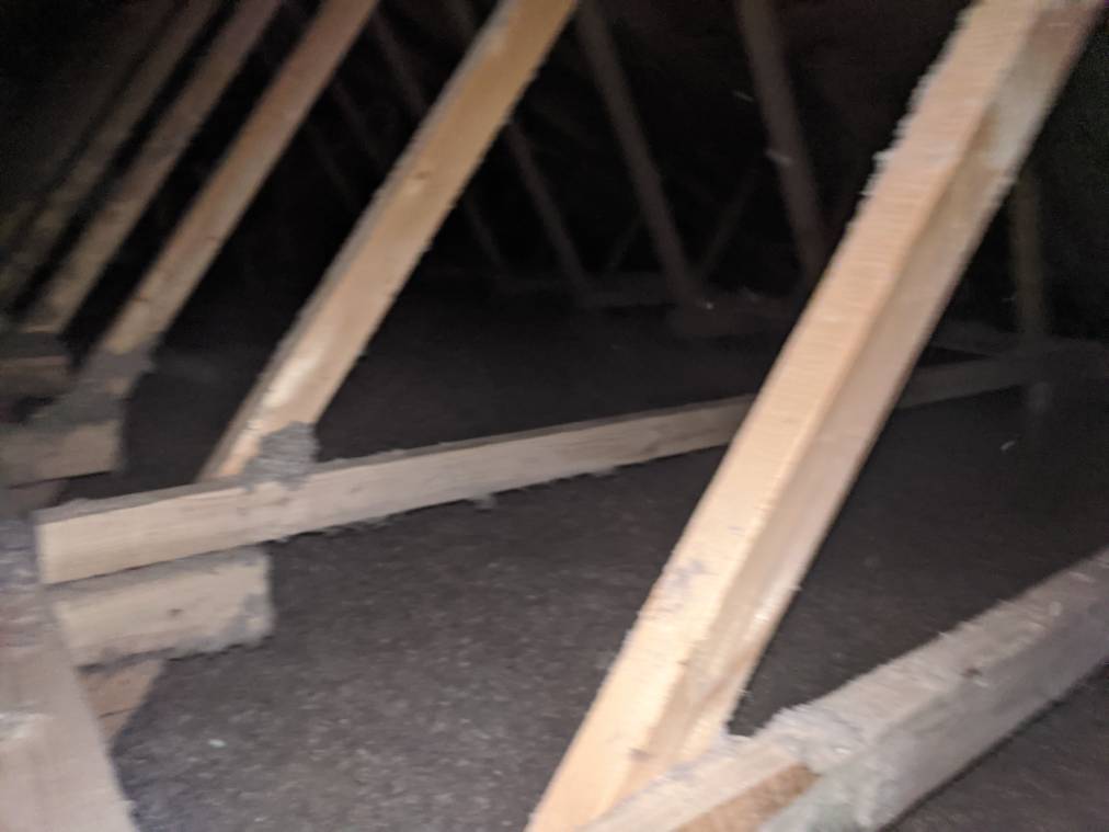

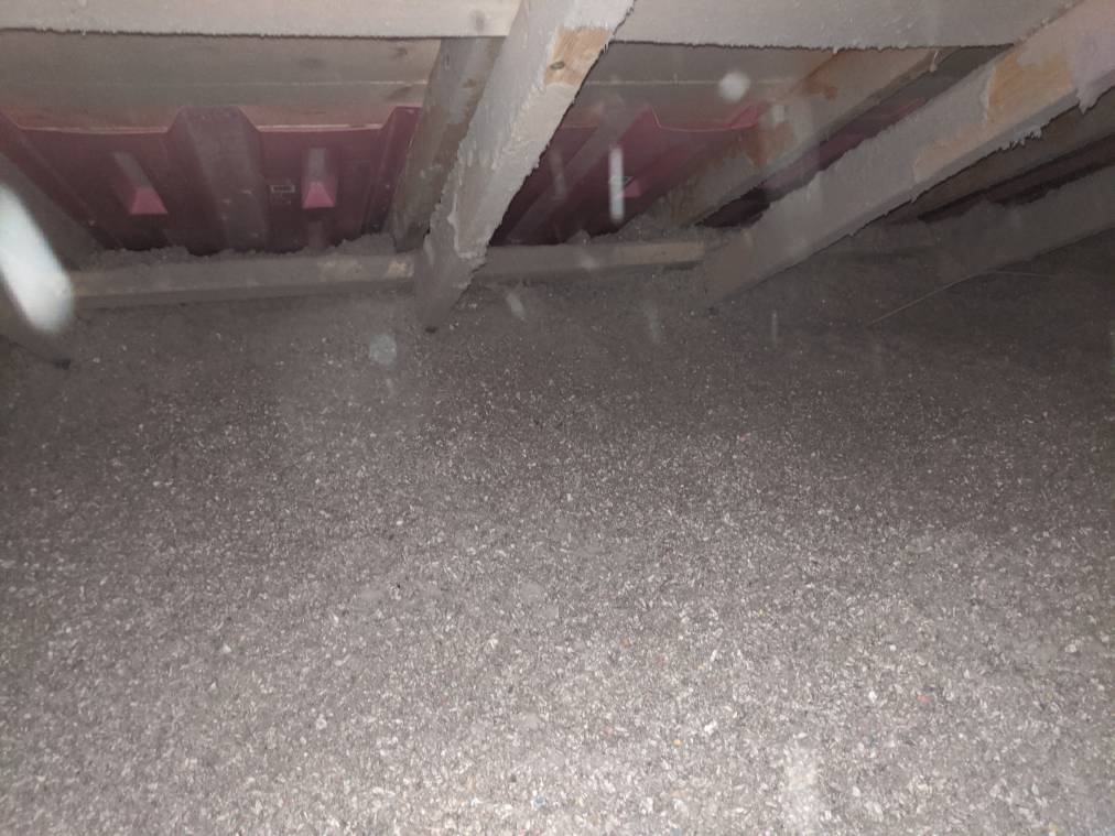

You might want to consider a bit more up top. I just blew in R60 in my attic and it only cost me CDN$1.10 per sq ft. I have a second floor on my garage that will become living space. The walls upstairs are R30, but the garage level walls are only R22. I do not plan to keep the garage level very warm so there were diminishing returns on going higher...so far. The garage ceiling will soon be R45 blown cellulose. It is a work in progress.

I blew in Thermoshield cellulose. I live in Canada so not sure what USA stores offer. Home Depot price is 10.60 per bag - 10% when buying more than 30 bags + 15% tax. A bag covers 11.9 sq.ft. at R60 so that works out to $1 per sq.ft. but I blew it in slightly thicker because it is not a perfect science when you are in a cloud of dust. HD did not have much stock so I actually bought from Kent building supplies for about the same cost. Blowing machine was free to use.
I chose cellulose because it is somewhat rodent proof - mice do not like the fireproofing content. Also, cellulose settles and I think that is better than Corning. Lots of differing opinions on these points so no need to discuss.
I built a walking platform in my attic; 2 rows of 1x6 planks at 24" high so I can crawl around above the insulation as required. Of course the attic hatch has 22" high walls so the 18.5" of insulation stays put.
The sound proofing is amazing compared to when I just had the vapour barrier and strapping. It should be cozy. IMG_20191211_162918.jpgIMG_20191211_162905.jpgIMG_20191211_111024.jpg
