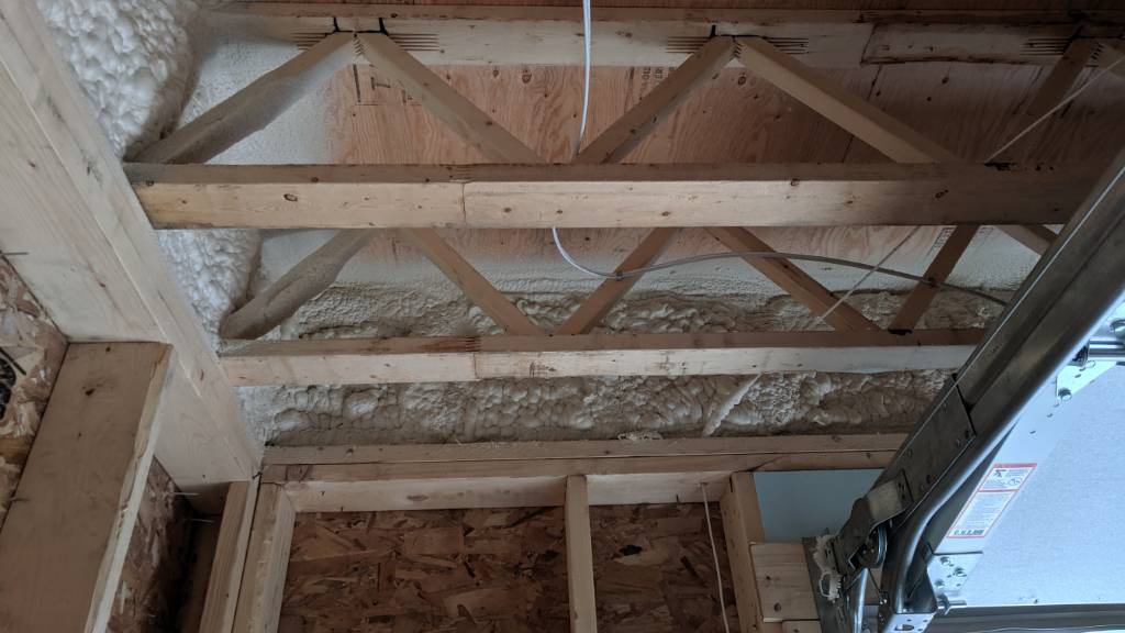

Get a couple of quotes from independent Insulation companies. I ended up with a professional job insulating my rim joists full (16" high x 5.5" deep) of spray foam for $100 more than the cost of the DIY canisters. IMG_20190617_141049.jpg
   / Garage/Shop Heater Installs? #84
Looks like a good plan. The rim joist job would be hard to do with batts, and tough to make 'em stay up there too.

My builder says most inadvertent heat loss is at the top wall plates. When our insulator spray foamed our house walls the builder had him also foam the top of the wall plate and up the batten boards like your pics.
After he told me what to look for I started paying attention to house roofs on frosty mornings. Very common to see heat loss from the wall plates.
