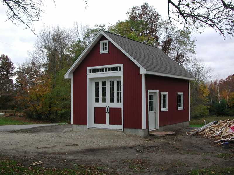

I'm going to start building number 2 this spring... Garage, shop... Then looks like my shop got changed to an in-law apartment.. all 1600 sqft of it that's not an apartment it's a house.
Anyway we changed the building to a 24X48 post and beam barn with a 14ft sidewall. The building has the second floor hung at 10ft and a half loft second floor. We'll have a full foundation under the building and a 22X48 fully enclosed lean-to at foundation grade level. This will house 4 cars.
The building is being built in an area that has a 6 foot elevation change so is would have been like a walk out basement.
16X24 will be the mechanical area for the apt. and 32X24 will be my woodshop....
Last fall we built a little tractor barn for the tractor and mechanical tools...

tractor barn pic
