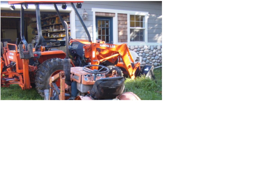

I didn't see anything about your door height. The biggest mistake I made on my garage was going with standard 7’ high doors. That was fine for everything I owned at the time, but I later bought my L35 and my truck with a rack. Neither will fit under 7’. Be sure your doors are tall enough to accommodate anything you might want to put in there in the future.
See photo
