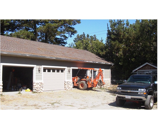

Frank
I didn't see anything about your door height. The biggest mistake I made on my garage was going with standard 7’ high doors. That was fine for everything I owned at the time, but I later bought my L35 and my truck with a rack. Neither will fit under 7’. Be sure your doors are tall enough to accommodate anything you might want to put in there in the future.
See photo
Fred

And yes go with the tallest over head door that you can.
