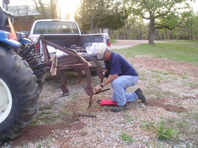

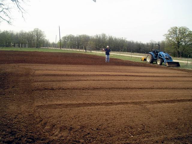

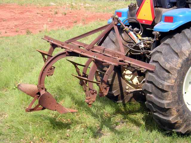

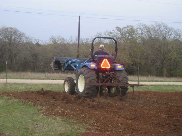

Jetro, I used a two bottom plow early last year to break up native soil in my garden and I don't have any pictures of that. However, after I broke up the soil, I purchased a 6' KK tiller like yours and tilled the garden spot and added sand in one area from a creek bottom. I then followed with an old Dearborn row cultivator to lay out the rows and make raised beds for planting. See photos...
It's funny that when I was a kid, we planted down in the furrow, but now I plant on top of the furrow like a raised bed and then I use my little gas powered garden tiller to pull the dirt up around the plants and keep the furrows for irrigation. This year's bean crop from the pictures I posted yesterday are an example. For tomatoes, watermelons, and squash, I make hills with the gas tiller and/or a hoe and four tine cultivating fork. For weed control, I use the gas tiller almost exclusively until the plants become so large they would be damaged, then I just use a regular hoe or pull weeds.
I do have a sub-soiler and I also have a middle-buster for my Dearborn cultivator (made from an old horse-drawn middle buster and welded up to fit the Dearborn). I use it dig ditches and layout deep furrows, but I haven't used it much for gardening. I'd use it to dig my potatoes, but my rows are so close together I think I'll just use my loader to dig two rows at a time.:) If I tried to use the middle buster, I'd bruise potatoes near the surface with my wheels when I drove over them.
