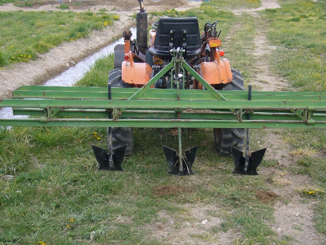

I've watched the farmers around here to figure out how to make rows. Lots of row crops and everything is flood irrigation. Even so it seems like everyone has just a little different setup. Generally they have multi-bar tool bars with various shovels, gage wheels, hippers, slide-outs etc. etc. Tools bars with the 2" or 2.5" shaft seem to be the modern way. I picked up this 'old school' 'corrugator' which can be set up similarly. (requires special clamps)
Just basic shovels so far:

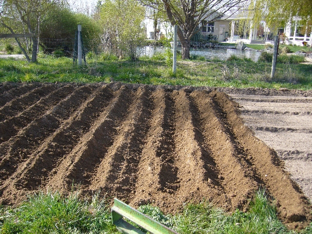

The rough rows:

What I found with this patch is the rows are too small. Flooding for irrigation causes the rows to break down/flatten out... so not so good. The next patch I did (no pics) I took the center shovel out. Moved the outer shovels in until the tips lined up with the inside edge of my tire. This made a row wide enough to plant a double row of corn... which is what I see farmers do around here. I put a set of shovels way out at the tips to help with aligning the next row etc.
I am looking for gage wheels... all of this stuff is expensive... and maybe a few small hipper disks. The dirt tends to go around the shovels and fall back into the furrows. You can use slide-outs (V shaped troughs that drag behind the shovel and pack the sides/bottom a little bit) or some use V shaped gage wheels behind each shovel to do the packing and depth control in one. Bigger shovels or shovels with 'wings' might help as well.
Kinda fun to mess around and learn about this stuff. Not too mention saving yourself a ton of labor with rakes etc. making rows.
