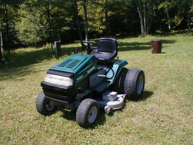

Well, I'df be remiss if I did not throw in a pic of mine.....

Gotts love duals, looking good! :D

I too have a Simplicity Sunstar albeit rebadged as a Duetz Ultima. LOVE the machine. Before I got that I did do a dual wheel get up on my cheapie MTD 19.5 HP tractor. Traction whent down in the wet. Duals as others stated provide floatation. Dry grass traction did increase/I could climb better. Side Hill stability as others here stated increased DRAMATICALLY!!!!!!!!!!!!!! Drawback- I used the method you referenced & used the wheel wheight holes on the wheels with a 6" pipe spacer with studs welded on to go into the wheel weight holes. The inner wheels started cracking around the lug nuts. For the stability alone I'll refabricate to use the lug bolts but were I doing it for traction I would not spend the time. Currently I'm going to post here inquiring about Ag tires versus tire chains for traction versus lawn damage... With the wide tires on the rear of the Sunstar, any moisture to the grass & all I get is wheel spin unless I engage the differential lock. I'm curious which of the 2 provide better traction without killing a nice lawn. I expect damage with wheel spin but I'd like to avoid lawn damage with turning ect.
