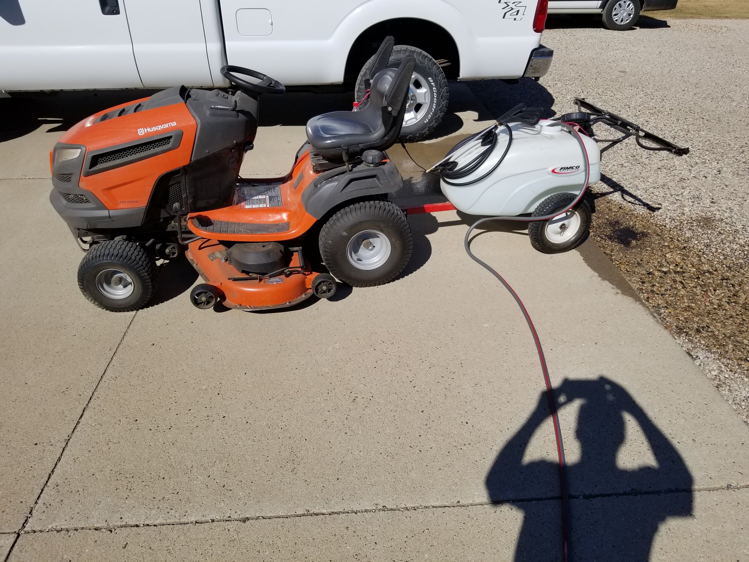

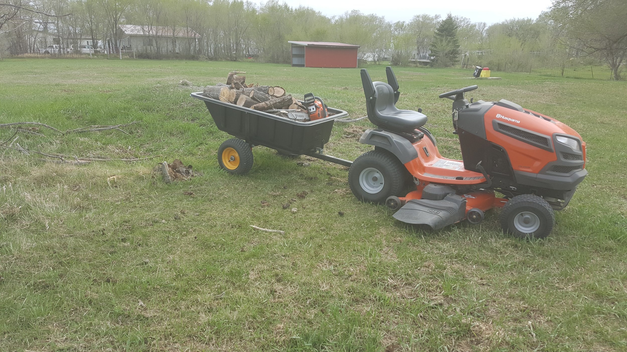

What kind of life span do you guys expect from a box store lawn mower tractor ?
I got a husquvarna yth22v46 that I bought used with 80 hours in 2019. Now it has almost 600 hours.
The mower it self is still pretty solid. Bumper smashed off. Hood is ragged from slamming into stuff but drives perfect.
Engine is healthy, oil changes regularly. Runs like a champ
Deck, I have ripped off both casters on my fence rows. The one side is ripped to shreds from processing branches and clipping stumps. Really need a new deck. Has had 1 spindle replaced and 3 or 4 sets of blades.
Do these things make 1000 hours regularly? I have a troubuilt with 400 hours that died a horrible death and a craftman that was junk with 200 ish hours. Solid motor on it but the rest was junk

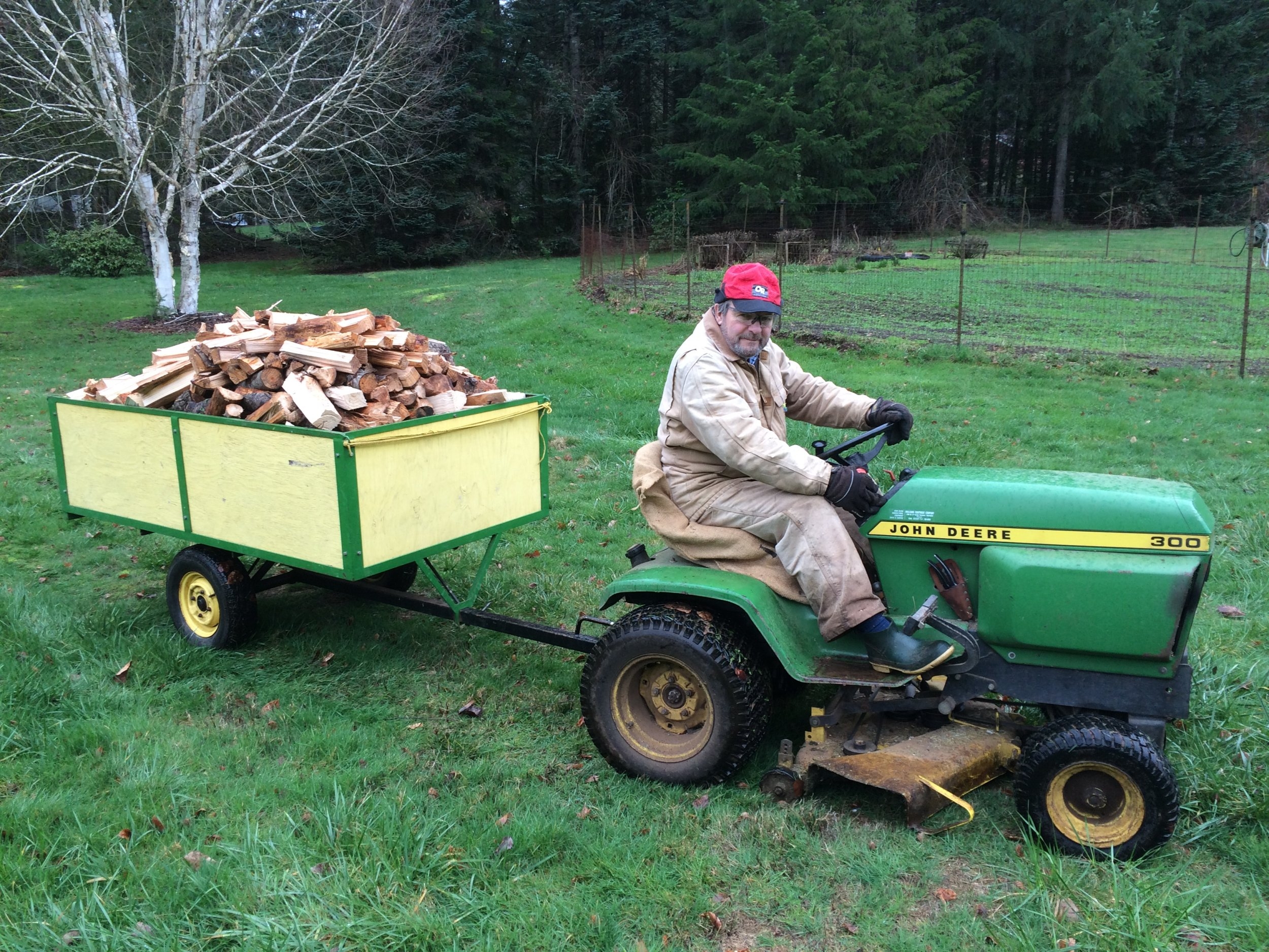

!976 John Deere 300 with plenty of hours just keeps going and going.
Regular maintenance, new connecting rod, starter and rectifier about 25 years ago, and new carburetor about three years ago.
