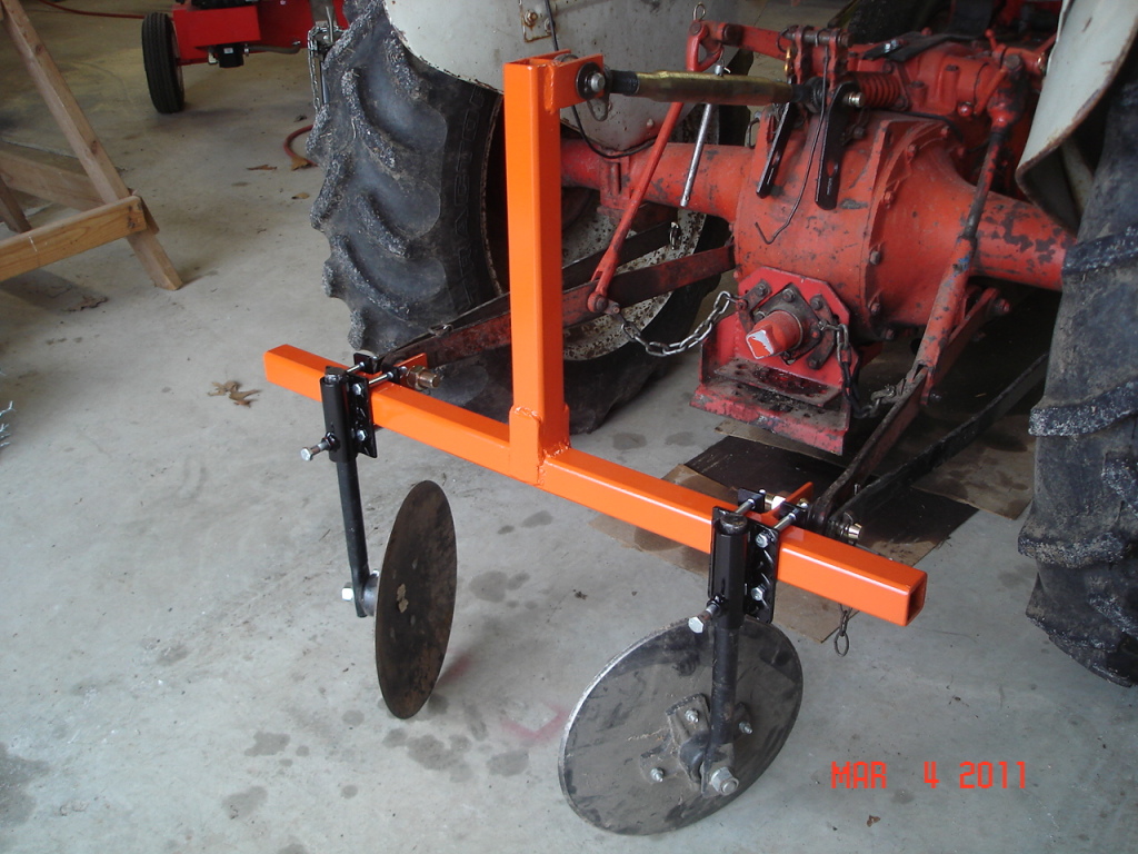

Also, I would like to make the beds mounded rows....I do not see an implement around our immediate area being sold that does this. So...can I take a cultivator,remove some tines, install a couple of discs mounted almost 90 degrees to the direction of travel to do this? What would be a good row spacing?
....as you can see,we need some input! Thanks!
BTW, I have a new JD 2520, 60" tiller, box blade ...if that helps with input. I can weld...and wouldnt mind making my own "hiller",and can copy a design or picture if its cost effective.

Something like this perhaps? Won't eat much, and takes up little space in the barn/garage. I'm sure we can both agree on a mutually beneficial design cost reimbursement. :D HTH, Mark
I built one very similar to this and it works great at hilling.
My plan is to use for potatoes this year and then swap out to a shovel for digging them. Should work fine.

I did my raised rows by putting 2 big 20" discs at 45 degree angles right behind the rear tires. Pounted the discs on an old soil ripper diamond bar. You can get a similar rig from Agri Supply called a Keulavator. You can also order the discs and clamps there.
Here's a photo of mine.
1/3 of an acre is an awful big garden. I have a 50x75 one that feeds lots of people. Made 20 rows in it.
