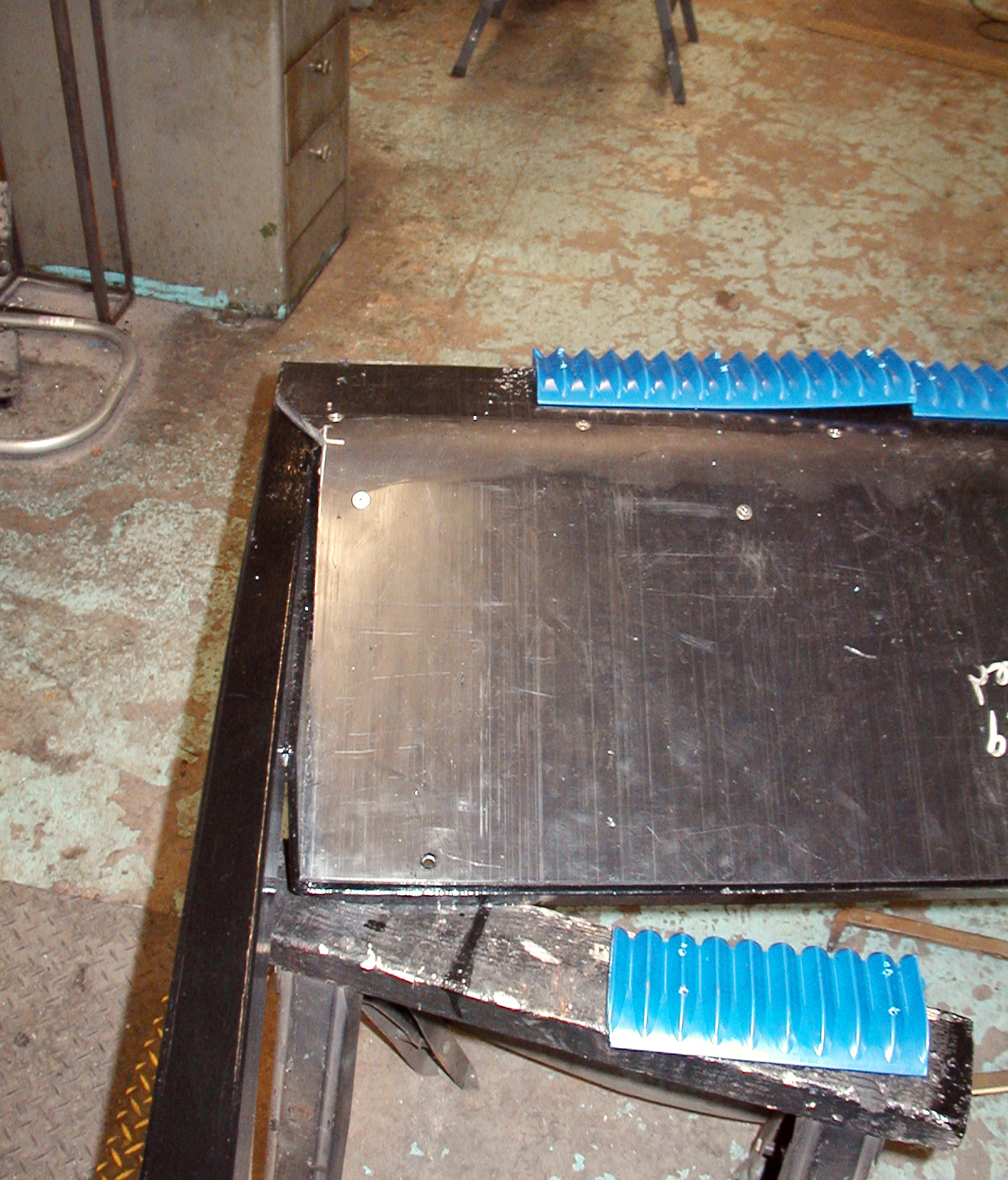

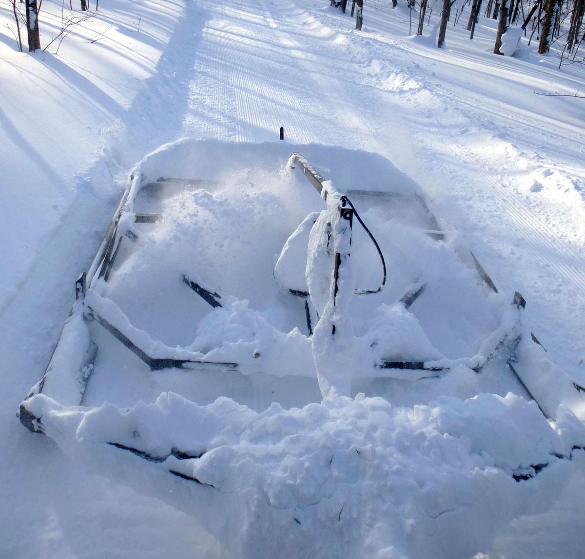

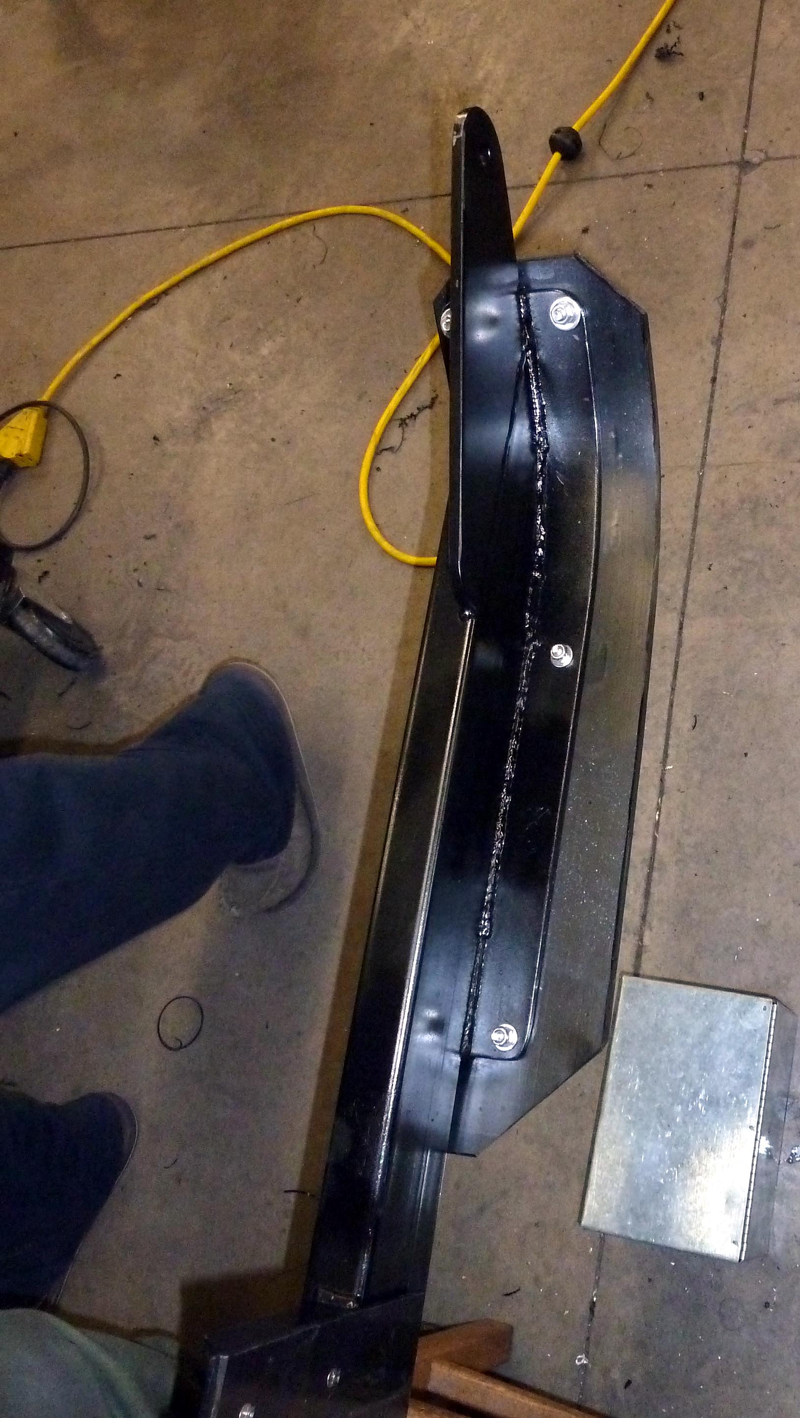

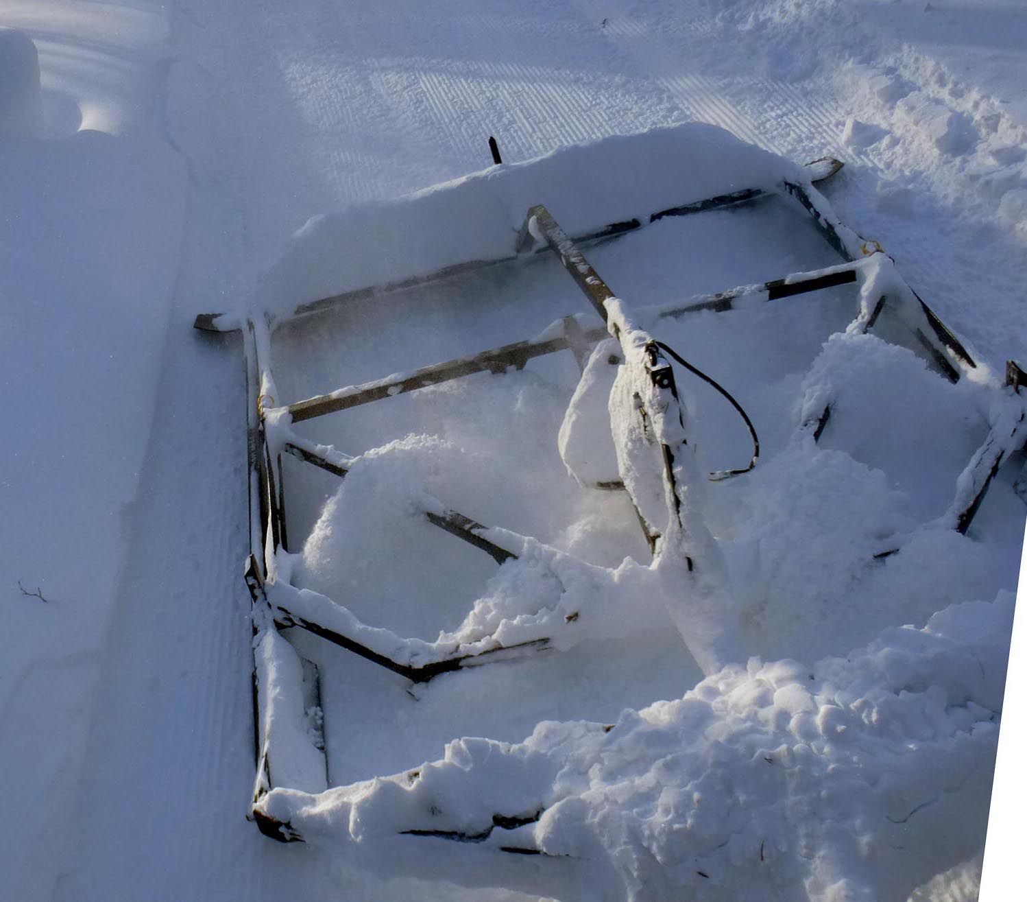

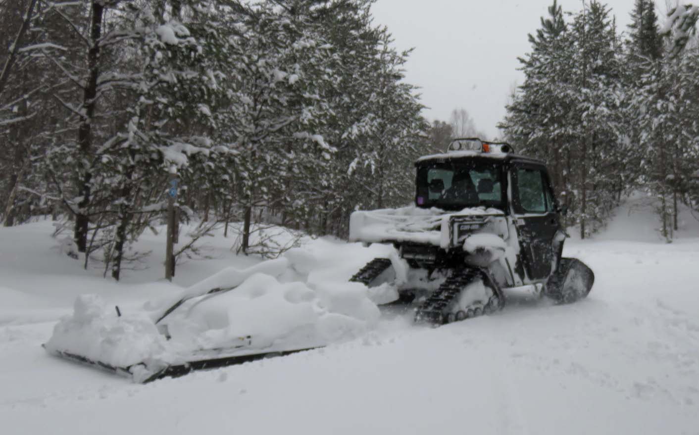

Are we getting away from fuel cans here??? I work in the snow industry and use it to make "shoes" or in general cover steel which snow passes under..
It cuts well with a sharp carbide wood blade as long as you feed it slowly. And since it has much higher expansion-contraction rates, one must attach is differently to allow this movement. I'll attach a couple of photos which shows plastic being used.. These machines do not ride on steel at all but only on HPDE plastic. I'll attach a few photos, some of the machine at work.
What do you use it for and how is it used?
I've often wondered if there are things I can make, but just don't have the skill and knowledge to make them because I don't know they exist.
