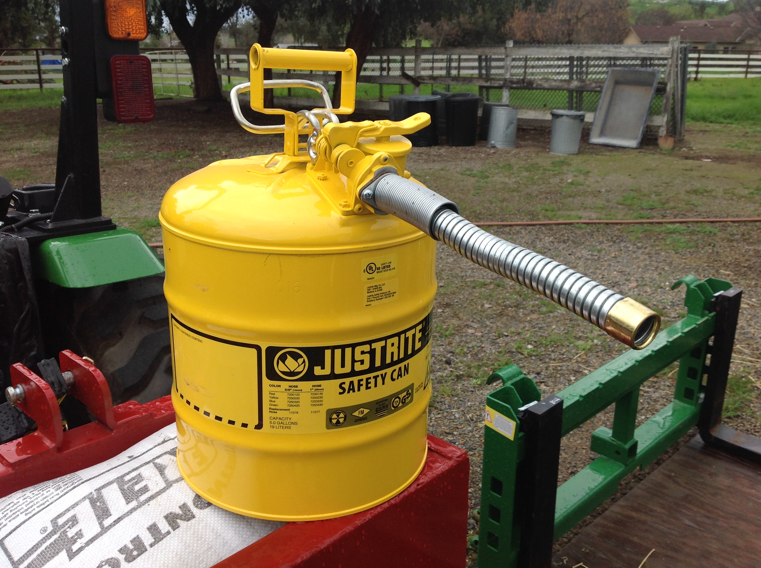

Trust me, stay away from plastic, it's junk, expands, and is dangerous. You will be replacing plastic very soon. These cans are awesome. Bought these from Amazon.
/ Gas cans - really
#24
Now that's what I am looking for! I have 2 cans just like it but w/o the fancy hose arrangement. They are great, but this would be much better.
Amazon, huh? I'll check it out.

Indeed, they have many different types of cans, including these (which look best to me). Not cheap, but quality never is.
$58 per.

Be warned, and scrutinize the specs. The flexible hose/spouts come in two diameters; I have forgotten but think they were 5/8" and 1". Get the larger diameter so you won't have to squeeze the vent handle as long.

I looked into those awhile back, but saw quite a few reviews about them leaking and that they are galvanized and fuel cannot be stored in them. I know some of the tractor manufacturers, including JD, specifically warn against using galvanized cans. I bought more plastic cans and added vents to speed fueling, just like GaryLock showed above.

Really, I ordered three yellow and two red ones and they shipped them to my front door, I don't see what would not be compliant about them, they have not leaked so far but I have not had them that long, I just know the quality feels and functions perfect, the size of the tube transfers fast enough for me. I never read anything about galvanized being a problem but I do appreciate the info and will look into it. I have owned plastic cans all my life and everyone always comments about those stupid safety spouts that never work and get fuel every where and they always crack and break, the plastic expands and you now have a six gallon plastic fuel container that looks like it's pregnant, lol.

Amazon may describe the Justrite cans as galvanized , but Justrite's website describes them as "coated" or "powder coated". Metal fuel cans used to be coated with "terne metal", an alloy of lead and tin, but that has changed owing largely to environmental factors. Terre metal changed to a zinc-tin and then (virtually) all tin alloy, and plastic coatings were developed. Meanwhile, fuel composition also changed with alcohols and other additives that may or may not be compatible with various coatings. My personal opinion is that many people, especially advertising copy writers, play fast and loose with their terminology, and frankly, true rigor would be as confusing to the layman as the ad-man's hype.
I have no connection with Justrite other than owning a couple of their cans (with which I am well pleased). I think that an established provider of premium (expensive) fuel containers has more to lose by mis-representing the suitability of their products so I have no problem using their yellow cans to temporarily store diesel fuel.

I've been using a Justrite can like that pictured by Catman8 (but red) for gasoline for about five years. It seems well built, works well, and causes next to no spills, and of course no sign of leaks. I use it for fuel for small engines, and find the spout works well to create a good swirl when I am creating oil/gas mix as well as getting all the gas into the tank on my lawn mower. It is heavy, and the spring on the fill opening is pretty strong, but all in all I like it.

The operator manuals for my backhoe AND tractor specifically warns against using galvanized tanks or cans for fuel storage.

That would be great if they are coated. I know their brochures say they are galvanized and show pictures of the shiny silver inside too, but maybe they have a clear coating. When I said there are complaints of them leaking, I should have clarified it was the flex spout that leaks when pouring sometimes, not the cans.
