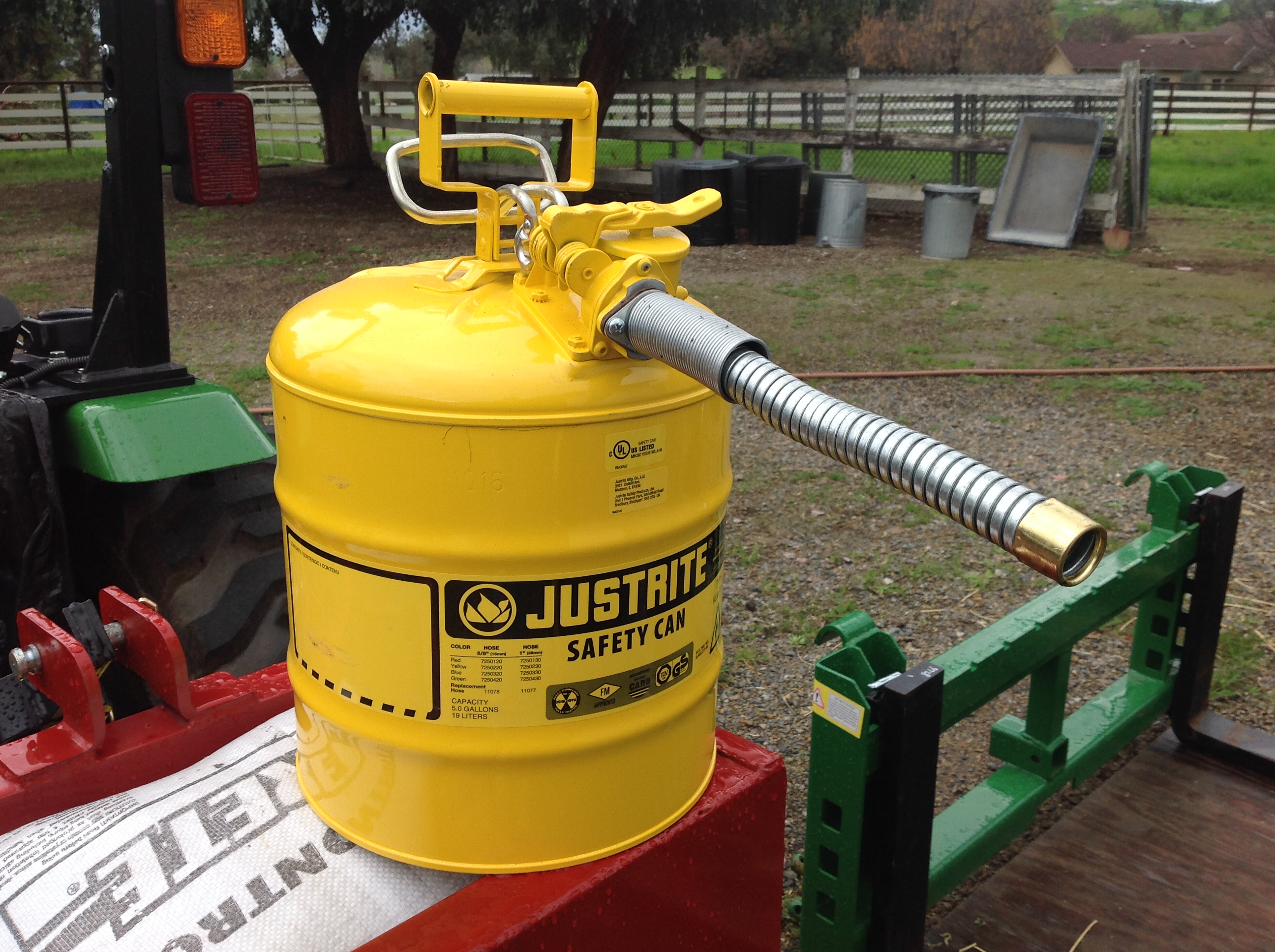

That would be great if they are coated. I know their brochures say they are galvanized and show pictures of the shiny silver inside too, but maybe they have a clear coating. When I said there are complaints of them leaking, I should have clarified it was the flex spout that leaks when pouring sometimes, not the cans.<snip>
My Just-Rites leaked a little but it just took a little tightening on the gaskets to fix.

When I assembled mine they came with a cork gasket that can be replaced very easy if it ever did start leaking, if they start leaking on the metal seams thats a whole different kind of leaking.

I've got two "just rites" that spend many years being knocked around the department with 95% ethanol (allegedly very corrosive), and now maybe a decade in my garage holding straight gas. There is no corrosion on them at all, and they do not leak. They do not have the fancy flexhose system, but just straight pour spouts. They are excellent cans.

I know for certain, those cans are good for gasoline and ethanol or both. That's an empirical fact. Even in a garage which gets 6+months of road salt dragged in every year. They are also very stable in the back of my pick up. But they can be hard to pour with the standard spout.

I'm not sure how risky it is to use galvanized cans, but there is a lot of discussion around it because of truck and tractor manufacturers now warning against it. When I read about this awhile back, there were calls made to the can companies. I remember some being told by the can manufacturer that if the tractor/truck owners manual said not to store fuel in galvanized cans, then they recommended not using their galvanized cans. After reading above and wondering if the cans are coated on the inside I called Justrite. They said their cans are galvanized on the inside and powder coated on the outside. I asked if the galvanized inside also had a protective coating for fuel, and they said no, just galvanized. Makes you wonder if the warnings are based on the wide variety of galvanized cans that could be used, so they warn against all to be safe.

The issue with galvanized and diesel is that the zinc reacts with sulfur in the diesel and gets into the fuel. Then the zinc is deposited inside the engine. Over time it can cause big problems.
It's only an issue with diesel. Not gasoline. I would not store diesel in a galvanized can under any circumstances.

I will have to call Just Rite and ask them why they would make a yellow can for diesel. You would think they would know about this issue you mentioned.

Justrite cans are well made I have 4 and i love them yellow for diesel red for gas and green for mixed oil and gas 2 cyl high doller but lasts a lifetime and the easy pour spout is a god send.
