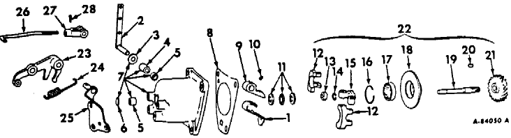

Just a guess, but sounds like the bumper spring under the governor cover is broken. #1 in exploded view below. While apart, better check the thrust bearing (#11) too, while the cover is off.
Spring looks to be about $32.00,and that bearing (hope yours is OK..!!) is right at $118.00 through Case/IH.
Guess that's cheaper than the engine having pups...
Many thanks "DJ" for both the analysis and especially the exploded diagram.
Was intimidated just looking at the governor housing. Will check it out in the light tomorrow.
