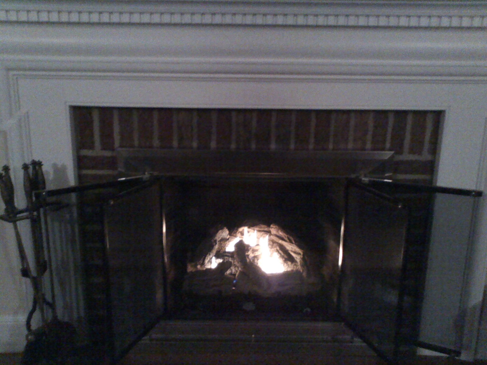

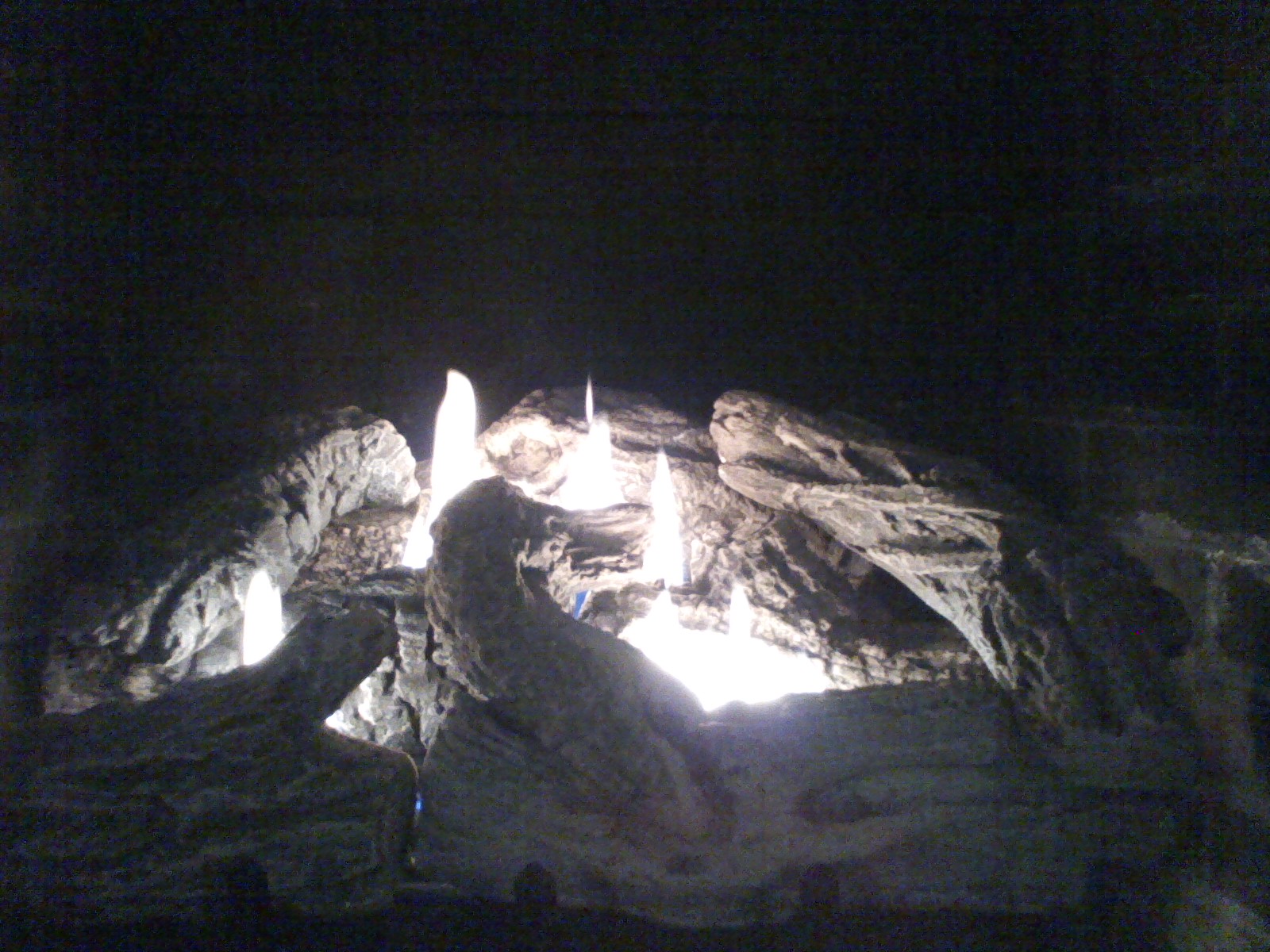

Update:
I got a gas log set from Lowes, only $240. a 100 pound propane tank and 2 stage regulator, and 25 feet of flex line. About $600. for everything.
Installed it today, this was a learning curve for me since I never had a gas appliance of any kind. My case was a little tricky getting the line in thru the back of the chimney in the basement and up thru the ash dump. but I made a custom termination plate to fit and seal the ash dump opening.
tried it out tonight and it was pretty nice, the flame is not real high but is ok, but man it does make some heat, raised the room temp 6 degrees in an hour, plus the heat went up the stairs and 2nd floor hallway.
It was making the wood work and mantel very hot to the touch, even though they met all the minimum distance requirements. and just the slightest smell. Not a bad smell, but more a hot smell, could be due to the first use.
This was with the damper completely closed tight. I think if I crack it slightly, it will help with all those issues.
Only cell phone pics

I know that different size logs have different clearances to combustible mat. but that wood looks close to the opening to me. They make a heat deflector shield (black or brass )you can purchase to divert the heat away from your mantle

If you have vented logs, you had better open that damper for your own safety. Also I recommend that you get a carbon monoxide detector.
I've had non-vented logs for about eight years. Last year I decided to buy a 55 inch tv and mount it on the wall above the fireplace. But I was concerned about heat affecting the electronics. So I got an indoor-outdoor digital thermometer and taped the probe onto a broomstick. then I probed around the area there the tv was going to be mounted 3.5 feet above the fireplace opening..
It's hard to tell, but it looks like your mantle is flush with the wall. Mine has a seven inch offset from the wall and that helps keep the updraft off the tv.

They recommend a hood if your combustibles fall below the minimum clearances, but mine are supposed to be good. 8 inches to the wood and 20 inches for a mantel that sticks out 6 inches, may have to consider the deflector though. or just crack the damper.
This is definitely vent less, sorry I didn't mention that.
32,000 btus. alot of heat pours out the top of the fireplace.
I do have a co detector in that room. I'm a little paranoid about gas, I may turn off the tank every night, but that's a big inconvenience. Everyone has them with the pilots on year round probably.
11 inch WC or about 0.8 psi I think.

I ran it a couple of hours last night, it seems to be the right fit for my needs/ wants. Definitely does not get to hot in the living room, that was one thing I was worried about, it gets to about 74 degrees. It looks good too.
It has not been that cold the last couple of days, but I can see by running it last night, you don't feel real hot even right in front of the fireplace, but the heat is pouring out the front going straight up to the ceiling, warms the room slowly then is circulating thru the house. not to hot in any one place but is raising the temp up, even upstairs. Overnight it was below freezing but the house was not that cold this morning to even need the central heating system. So it may actually save a little on our oil heat bill.
I've got the damper/flue cracked about 1/4 inch, which seems to have eliminated most of the perceptible "smell" which is really not a bad smell, but was just something noticeable in the air.
